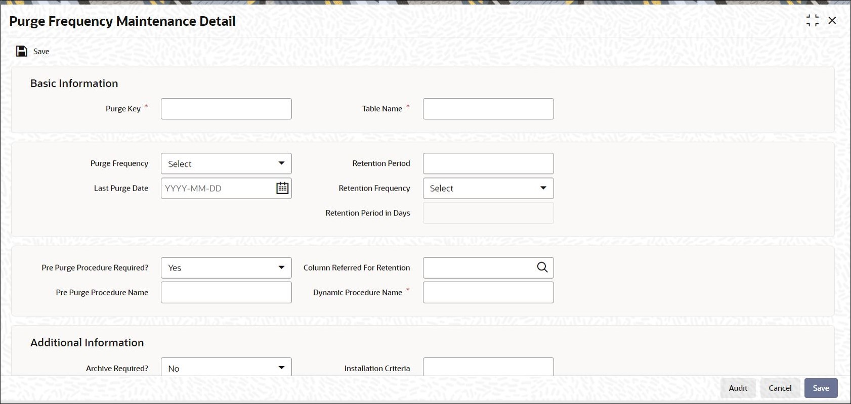

- On Home Screen, type UTDPURGS in the text box, and click Next.The Purge Frequency Maintenance Detail screen is displayed.
Figure 1-1 Purge Frequency Maintenance Detail
- On Purge Frequency Maintenance Detail screen, click New to enter the details.For more information on fields, refer to the field description table.
Table 1-1 Purge Frequency Maintenance Detail - Field Description
