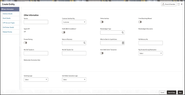

2.3.3 Other Information
This topic explains the Other Information section in the Basic Information tab of Create Entity screen.
- On Create Entity screen, click Basic Information tab to enter the other information details.The Other Information details are displayed.
- On the Other Information tab, specify the fields.For more information on fields, refer to the field description table.
Table 2-3 Other Information - Field Description.
