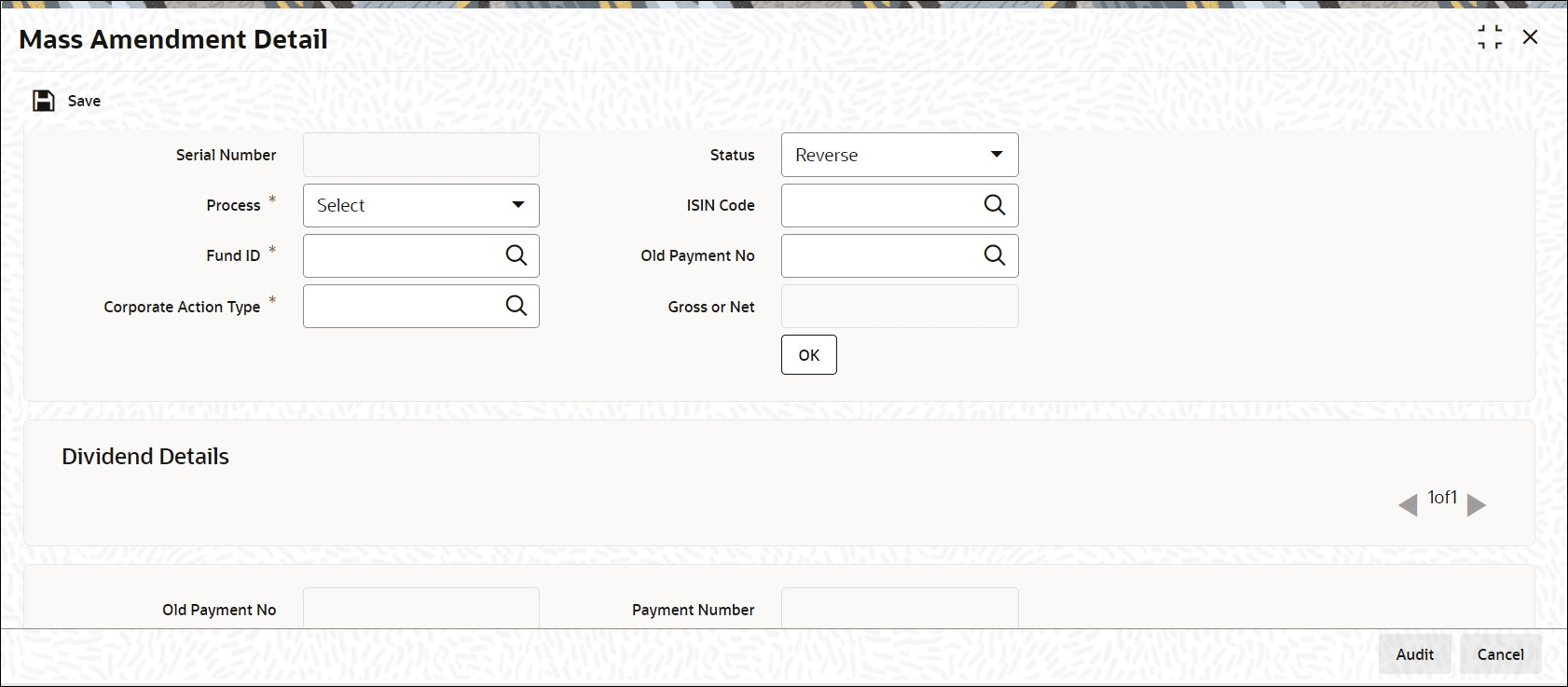

- On Home screen, type UTDMASAM in the text box, and click Next.The Mass Amendment Detail screen is displayed.
- On Mass Amendment Detail screen, click New to enter the details.For more information on fields, refer to the field description table.

- Select Reverse option in the Process field in this screen to signify reversal.
- Select Authorize option in the Actions list to authorize the reversal of the dividend.
After authorization, the reversal is processed by reversing the dividend and reinvestment entries passed, and posting the applicable adjustment entries.
