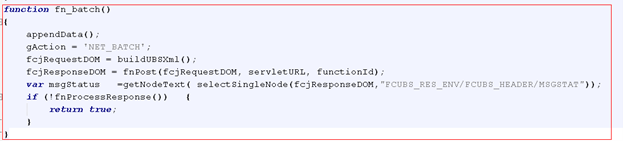

Custom action codes defined by the developer are defined in the JavaScript file. It is usually defined by the click of a button. The action code is defined and the request xml is built and passed to the server.
These codes are written in release specific JavaScript file
Example: Figure below shows a snippet from STDCSNET_CLUSTER.js
The fn_batch() which is invoked on clicking of the Process button.Here action code is set as NET_BATCH and request xml built and passed to the server and response processed based on response xml.
