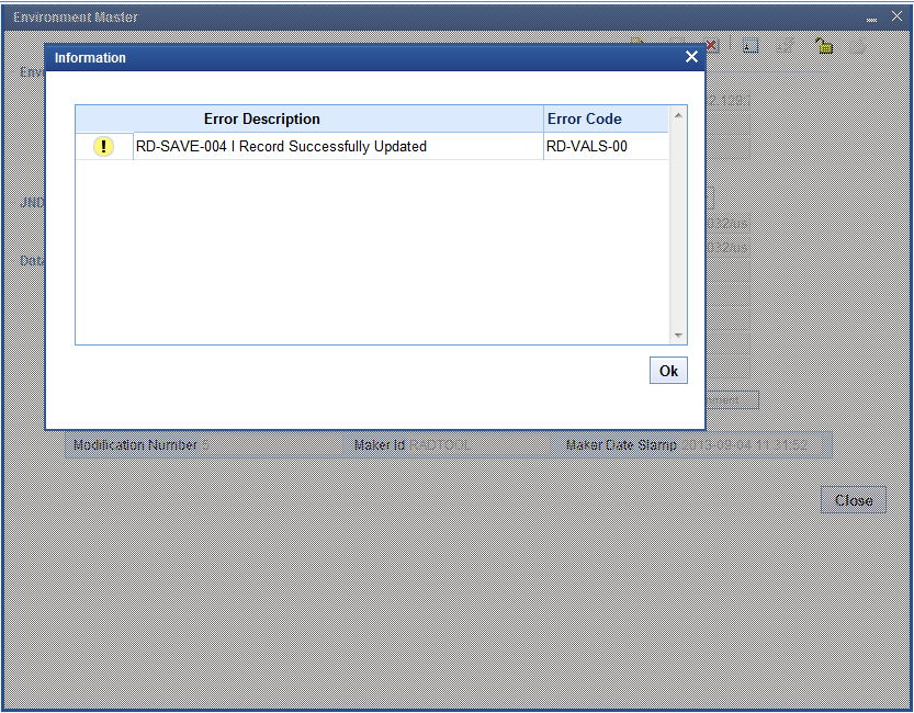

File Manager User Name Enter user name. This is an optional field. File Manager Password Enter password. This is an optional field. - Once an environment is created, the user must save the environment.
- User can modify the existing environment details. Click on detailed node of
environment list and click the Enter Query button.Environment code fields will get enabled.
- When Environment Code field gets enabled, enter environment code either directly if known already or select from provided list of values.
- Click Unlock button and modify required fields and click
Save.
