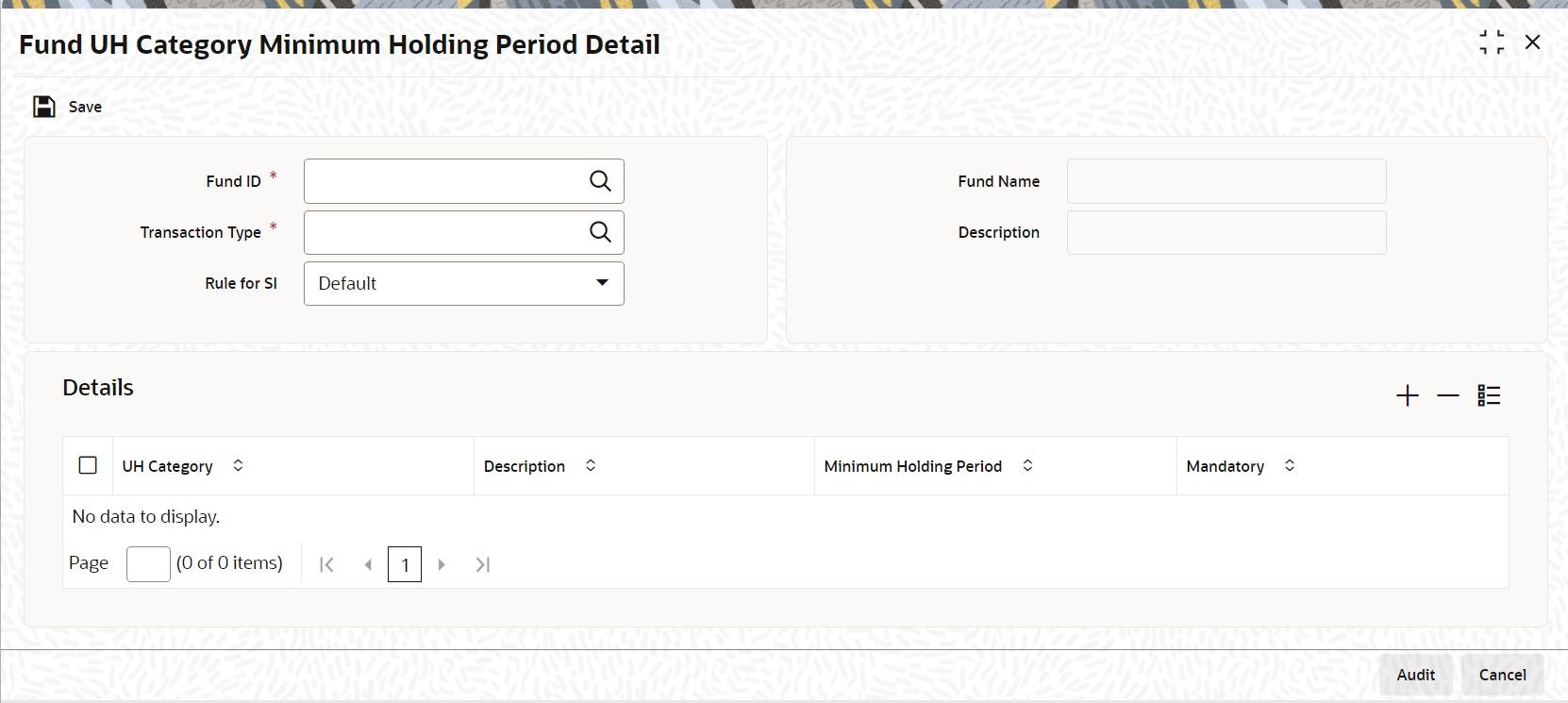

This topic provides the systematic instructions to capture the minimum holding period at Fund/ UH category/Transaction Type level.
  1. On Home screen, type UTDMINHL in the text box, and click Next.
    The Fund UH Category Minimum Holding Period Detail screen is displayed.
    Figure 3-17 Fund UH Category Minimum Holding Period Detail
  2. On Fund UH Category Minimum Holding Period Detail screen, click New to enter the details.
