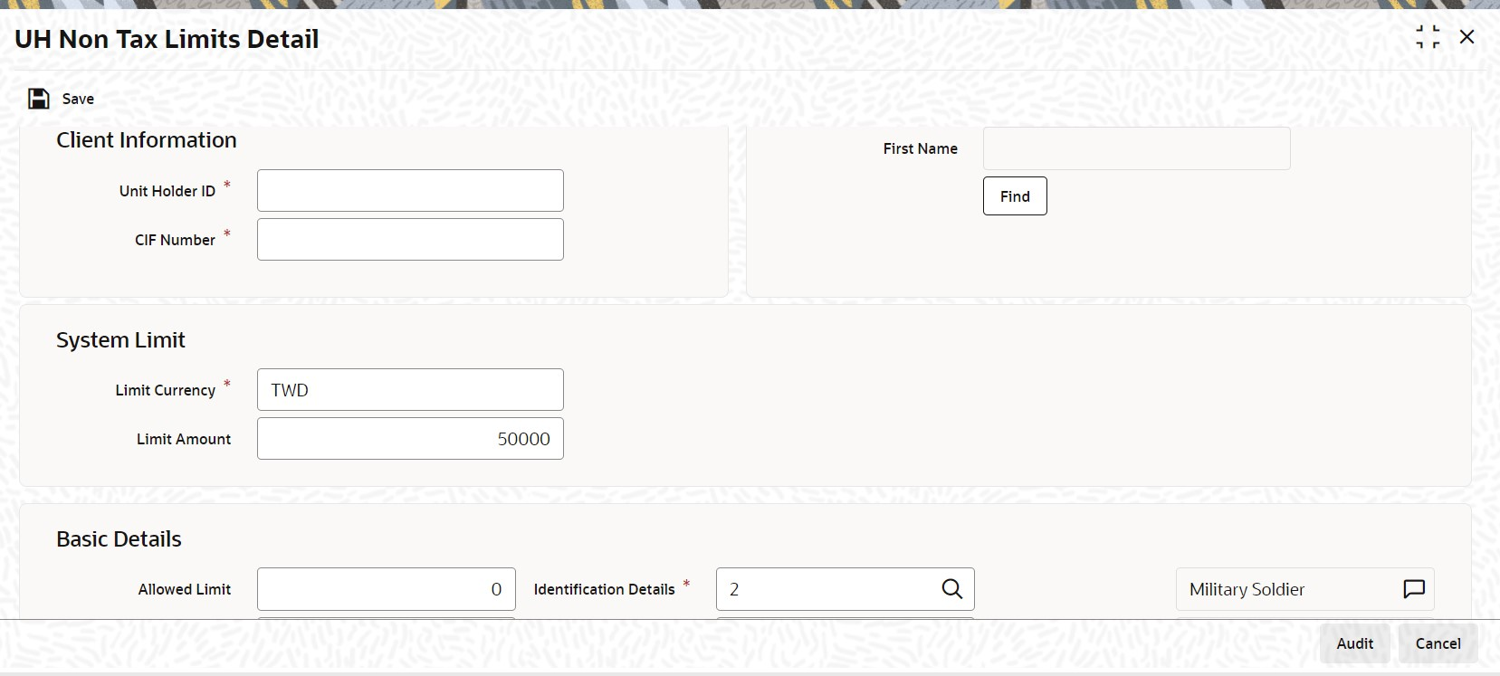

- On Home screen, type UTDUHNTX/ UTDURATX in the text box, and click Next.The UH Non Tax Limits Detail screen is displayed.
- On UH Non Tax Limits Detail screen, click New to enter the details.For more information on fields, refer to the field description table.

Field Description Client Information In this section, select the ID of the unit holder for whom you are specifying non-tax limit options.
Unit Holder ID Alphanumeric; 12 Characters; Mandatory
Enter the CIF unit holder ID for whom you are creating the non-tax limit options.
First Name Display
Specify the ID of the non-CIF unit holder for whom you are setting up the non-tax limit options in this screen. The name of the unit holder that you select is displayed alongside the field.
CIF Number Alphanumeric; 20 Characters; Mandatory for setting up non-tax limit options for a unit holder under a CIF Account
Select or specify the number of the CIF account under which the unit holder for whom you are creating the non-tax limit options is found.
When you specify the CIF number, the name of the corresponding CIF account is retrieved from the database and displayed alongside the field.
All the unit holder accounts under the CIF account that you have selected are listed in the drop down list in the unit holders for CIF field.
You can query unit holder ID and CIF number by clicking Find button.
