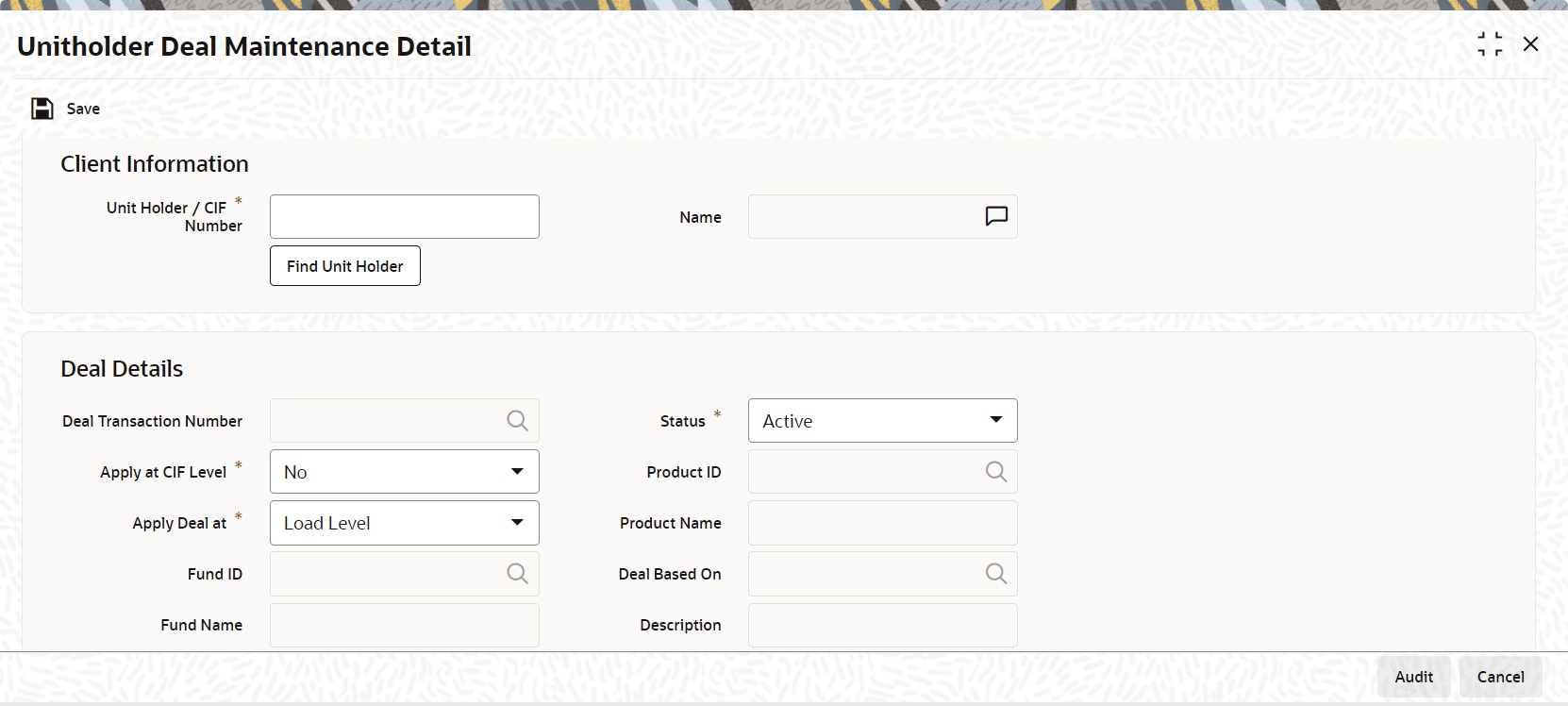

- On Home screen, type UTDUHDEL in the text box, and click Next.The Unitholder Deal Maintenance Detail screen is displayed.
Figure 3-6 Unitholder Deal Maintenance Detail
- On Unitholder Deal Maintenance Detail screen, click New to enter the details.For more information on fields, refer to the field description table.
