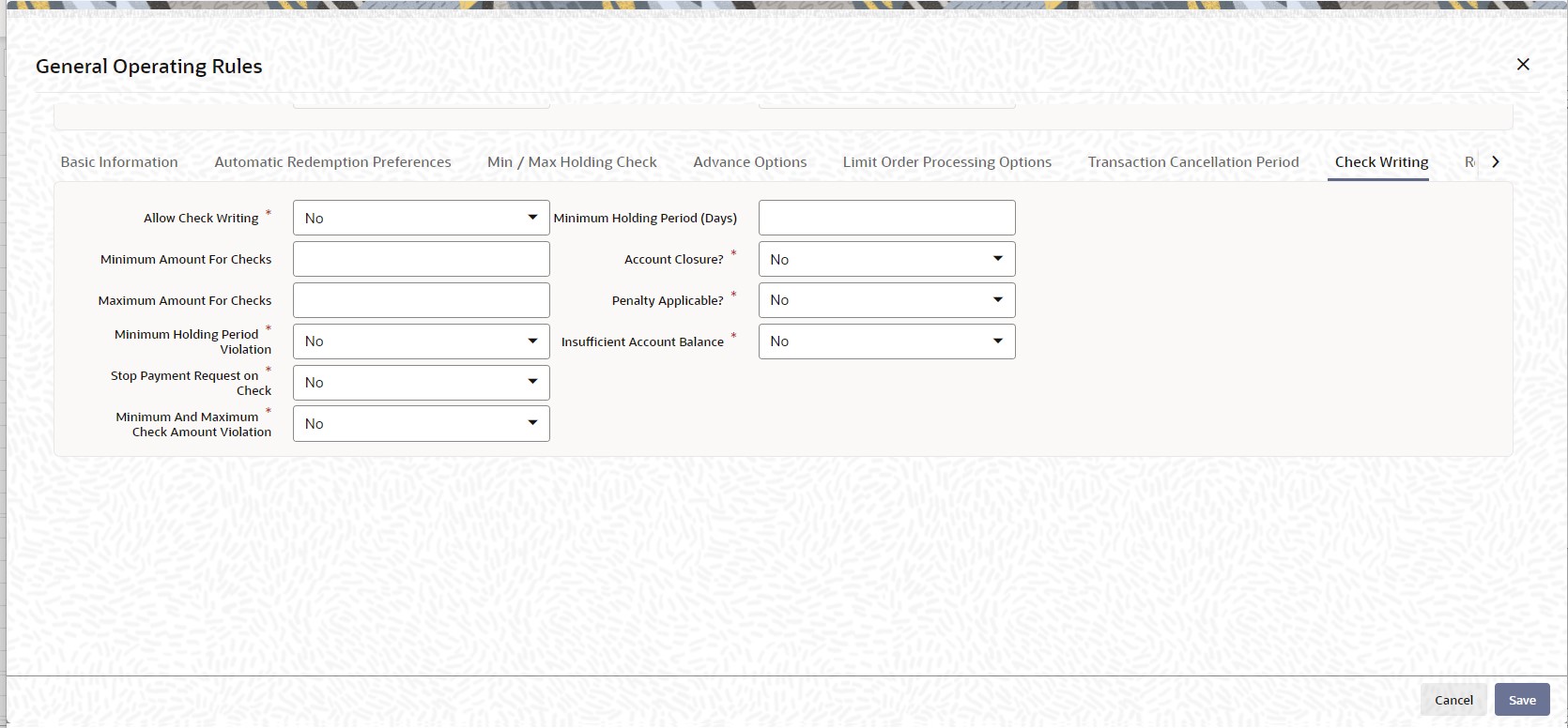

| Allow Check Writing | Mandatory You can use this field to indicate whether cheque writing facility is allowed for investors who invest in this fund. Select Yes from drop-down list to indicate that cheque writing is allowed. |
| Minimum Amount for Checks | Numeric; 18 Characters; Optional - If cheque writing is allowed for the fund, then this information is mandatory. Specify the minimum amount that can be redeemed through a redemption cheque, for investors holding balances in the fund, who have opted for cheque writing facility. If the amount written on a cheque falls below this value, the cheque attracts penal charges. |
| Maximum Amount for Checks | Numeric, 18 Characters; Optional - If cheque writing is allowed for the fund, then this information is mandatory. Specify the maximum amount that can be redeemed through a redemption cheque, for investors holding balances in the fund, who have opted for cheque writing facility. If the amount written on a cheque exceeds this value, the cheque attracts penal charges. |
| Minimum Holding Period Violation | Mandatory You can use this field to indicate whether a violation of the holding period for balances in this fund, by a unit holder using the cheque writing facility must be validated for. Select ‘Yes’ from drop-down list to indicate validating of violation of the holding period. |
| Stop Payment Request on Check | Mandatory You can use this field to indicate whether a stop payment request can be applied on a cheque issued by a unit holder availing cheque writing facility, for this fund. Select Yes from dropdown list to indicate that a stop payment can be applied. |
| Minimum and Maximum Check Amount Violation | Numeric; 6 Characters; Mandatory You can use this field to indicate whether a violation of the minimum and maximum cheque amounts by a unit holder using the cheque writing facility in this fund, must be validated for. Select Yes from drop-down list to indicate validating of violation of the maximum and minimum cheque amounts. |
| Minimum Holding Period (Days) | Numeric; 5 Characters; Optional - If check writing is allowed for the fund, then this information is mandatory. Specify the minimum number of days for which units must be held in the investor account before they can be redeemed through a redemption cheque. |
| Account Closure | Mandatory You can use this field to indicate whether an investor can close the unit holder account through cheque redemption. SelectYes from drop-down list to indicate that account closure through cheque writing is allowed. |
| Penalty Applicable | Mandatory You can use this field to indicate whether an investor can close the unit holder account through a cheque redemption. Select Yes from drop-down list to indicate that account closure through cheque writing is allowed. |
| Insufficient Account Balance | Mandatory You can use this field to indicate whether insufficient balance in this fund, in the account of a unit holder using the cheque writing facility must be validated for. Select Yes from drop-down list to indicate validating of insufficient balance situations. |
