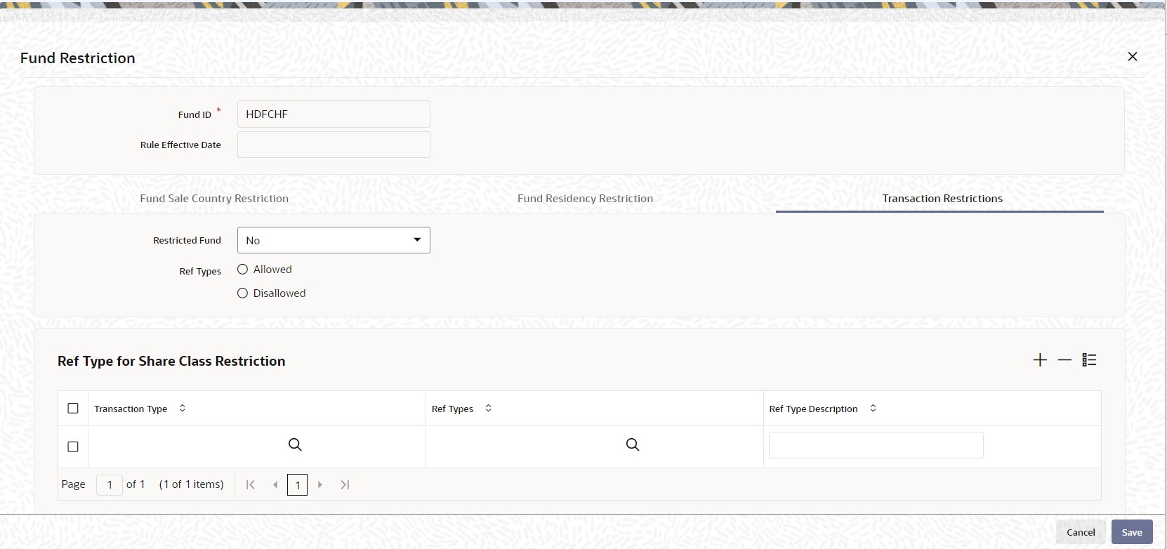

2.1.8.3 Inflow Restriction
This topic provides on inflow restriction tab of fund restriction screen.
- Click Fund Restriction, click Inflow Restriction tab in screen to specify the details.The Inflow Restriction screen is displayed.
Figure 2-26 Fund Restriction - Transaction Restriction
- On Inflow Restriction tab, specify the details.
For more information on fields in the screen, refer the below table.
Table 2-40 Fund Restriction - Inflow Restriction Tab
