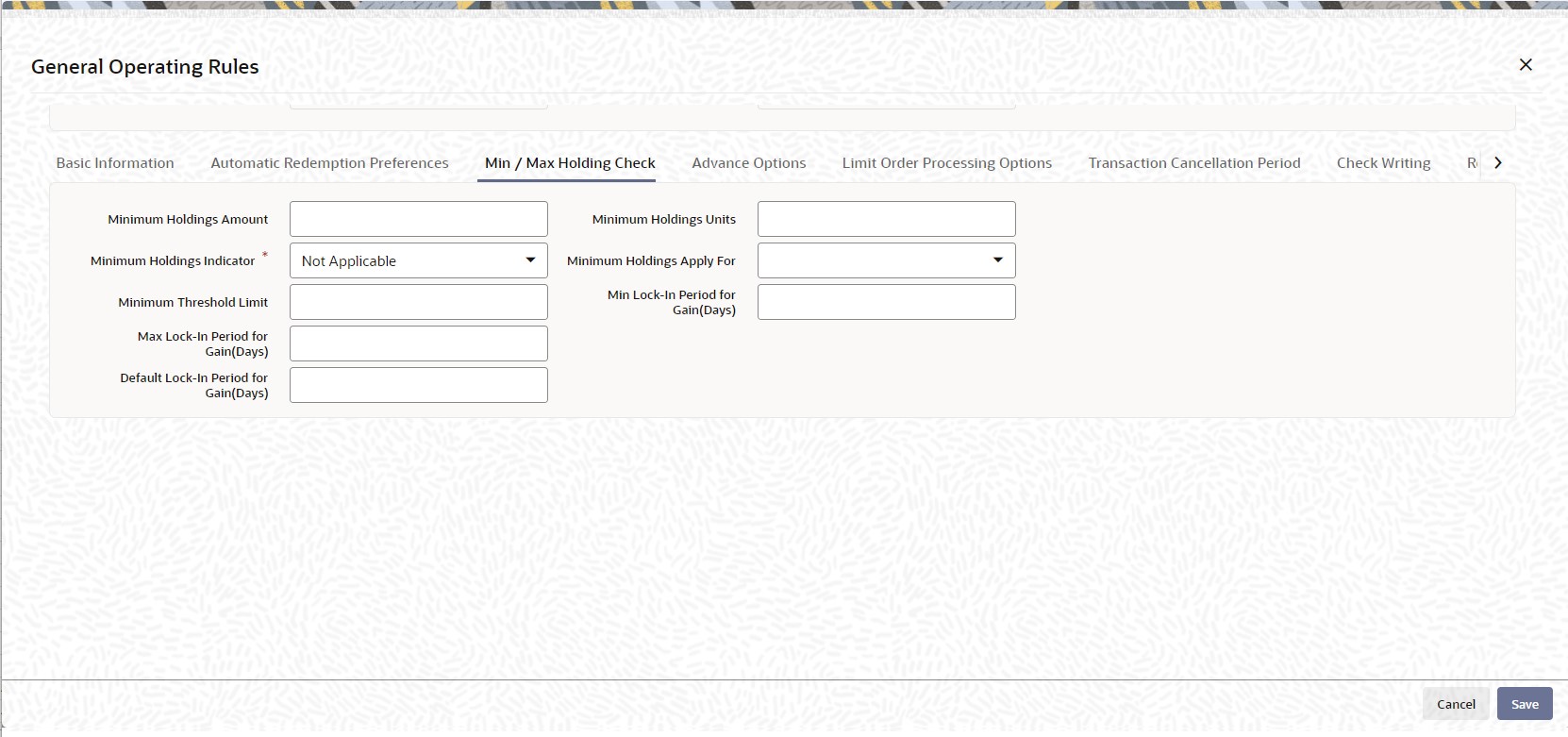

2.1.6.3 Min or Max Holding Check
This topic provides information on min/max holding check tab details.
You can indicate the minimum/maximum holdings balance that is required for redemption, switch or transfer transaction, for a CIF or an individual unit holder, in the fund. The minimum holdings value can be specified either as an amount, number of units, or redeemable value of units.
- Click on Min/Max Holding Check tab in General Operating Rules screen to specify the details.The The Min/Max Holding Check details are displayed in General Operating Rules screen.
As part of the minimum holdings options, you can also indicate whether the holdings considered for validation are those of all unit holders under a CIF, or for an individual unit holder.
The above check is not validated online during transaction capture or authorization. When there are transactions into a fund violating the minimum holdings validation, the system logs an exception in the Pre-End of Day Check screen. During the End of Day processes, the system allocates the transactions, logging the exceptions in respect of them.For more information on fields in the screen, refer the below table.

Field Description Minimum Holdings Amount Numeric; 18 Characters; Mandatory if Minimum Holdings Indicator is specified Specify the minimum redeemable value of holdings in the fund, for a redemption, switch or transfer transaction involving a CIF or individual unit holder.

Minimum Holdings Indicator Mandatory Select the basis upon which the minimum holdings check is performed from the drop-down list. The list displays the following values:
- Amount: The value of holdings (at redemption price). If you choose this option you must specify the minimum amount in the Minimum Holdings Amount field. If the check is to apply at CIF level, the redeemable value of units held by all unit holders under the CIF in the fund is checked against the Minimum Holdings Amount.

Minimum Threshold limit Numeric; 5 Characters; Optional Specify the percentage value to be applied on minimum balance amount or units setup here.
Max Lock-in Period for Gain (Days) Numeric; 4 Characters; Optional Specify the maximum lock-in period beyond which if the subscription is redeemed gains would be passed over to the Unitholder and so IOF and IRRF taxes will be applicable. This should be greater than or equal to the Min Lock-in Period.
Note: When a transaction is redeemed within the Lock-In period, redemption happens at the lowest applicable NAV as on date of Subscription or on the date of Redemption.
Default Lock-in Period for Gain (Days) Numeric; 4 Characters; Optional Specify the default lock-in period within which if the subscription is redeemed no gains would be passed over to the Unitholder and so IOF and IRRF taxes will not be applicable.
Note: The default lock-in period should be within the minimum and maximum lock in period.
Minimum Holdings Units Numeric; 27 Characters; Mandatory if Minimum Holdings Indicator is specified Specify the minimum number of units required to be held by an individual unit holder, or a CIF, in the fund, for a redemption, switch or transfer transaction.

Minimum Holdings Apply For Optional Select whether the minimum holdings check is applicable for CIFs, or for individual unit holders from the drop-down list. The list displays the following values:
- CIF
- Unit Holder
If you select CIF option, the redeemable value of the total number of units held by all unit holders under the CIF in the fund is considered for validation.
Min Lock-in Period for Gain (Days) Numeric; 4 Characters; Optional Specify the minimum lock-in period applicable for the fund. During subscription transaction, the lock-in period specified at the transaction level should be equal to or greater than the minimum period indicated here.
