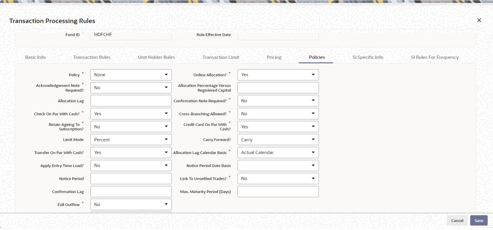

2.1.7.6 Policies
This topic provides information on policies tab of transaction processing rules screen.
In this section, you can set up the following information:
- Allocation details such as allowing of online allocation, credit card/check allocation on par with cash, allocation and confirmation lags, and the allocation policies.
- The limit redemption mode, which can be either percentage of holdings, amount or units.
- Click Transaction Processing Rules, click Policies tab in screen to specify the details.The Policies screen is displayed.
- On Policies tab, specify the details.
For more information on fields in the screen, refer the below table.
Table 2-34 Transaction Processing Rules - Policies
