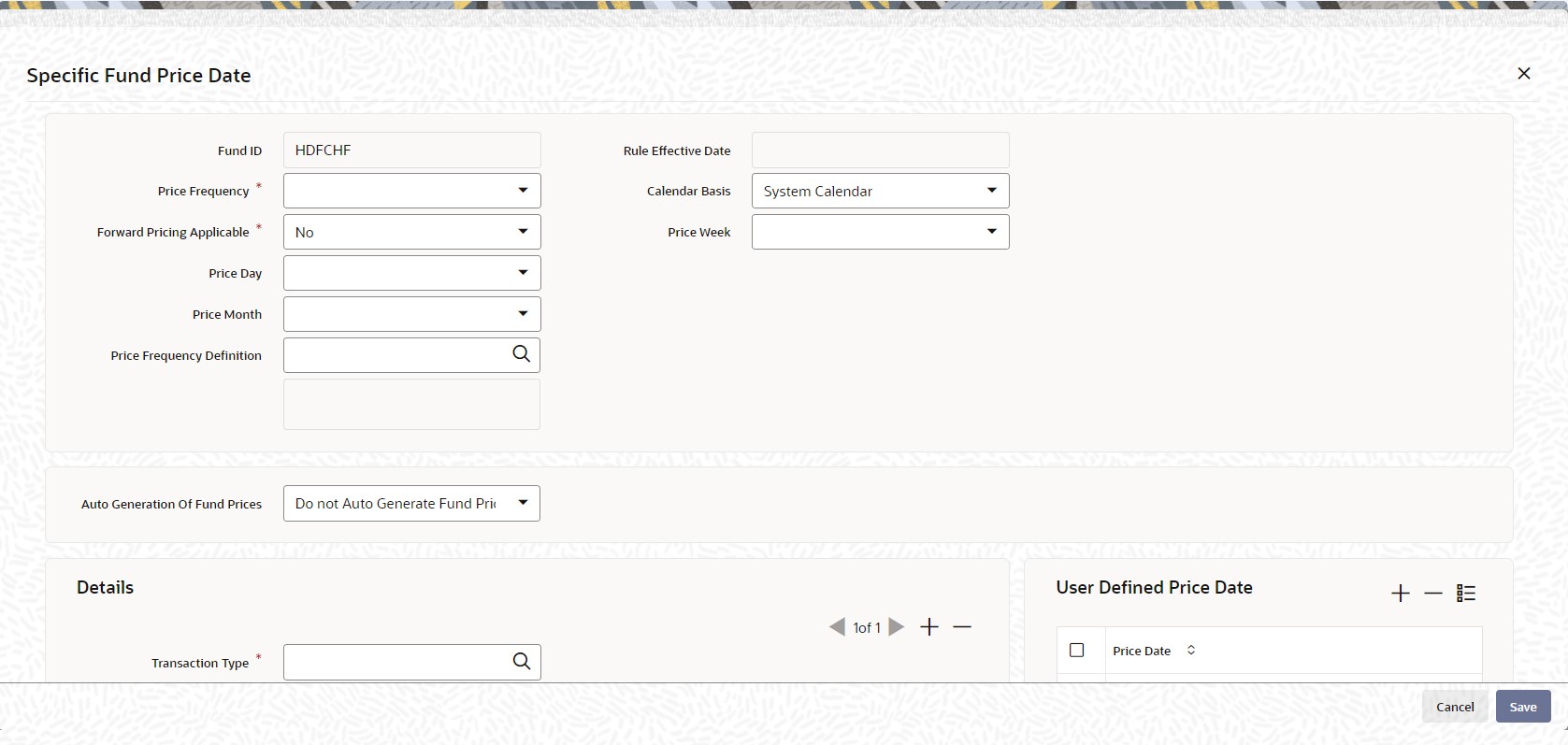

To set up specific price dates for any transaction types mapped to a fund, use the Specific Fund Price Date Setup screen.
  1. Click Specific Fund Price Date button from the Fund Rules Detail screen
    The Specific Fund Price Date screen is displayed.
    Figure 2-32 Specific Fund Price Date

  2. On Specific Fund Price Date screen, specify the fields.
    For more information on fields in the screen, refer the below table.
