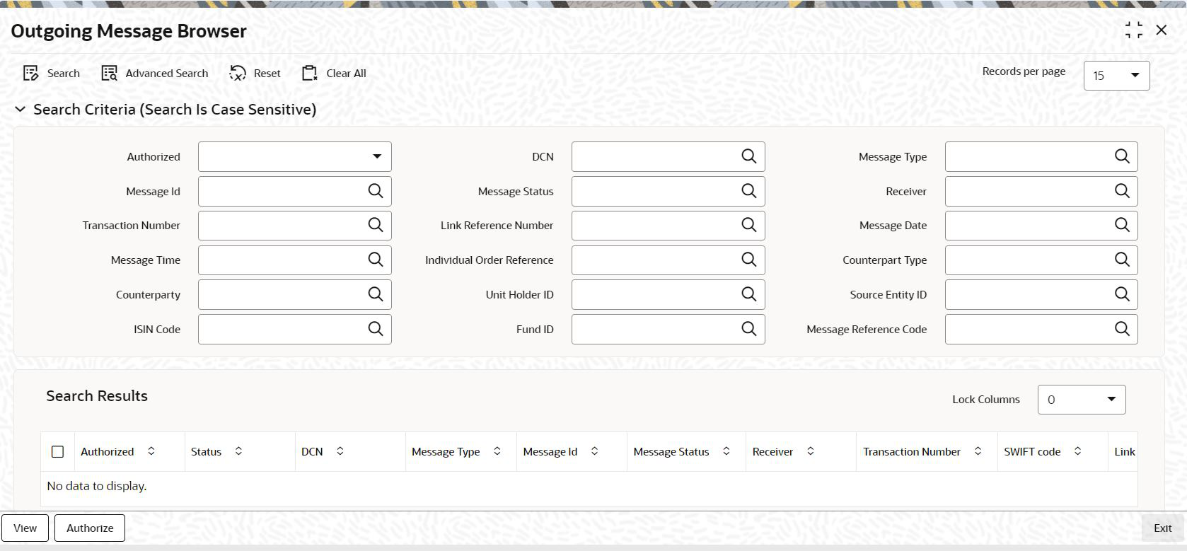

- On Home screen, type UTSMSGOT in the text box, and click Next.The Outgoing Message Browser screen is displayed.
- On Outgoing Message Browser screen, click New to enter the details.For more information on fields, refer to the field description table.Table 2-13 Outgoing Message Browser - Field Description Field Description Attributes Authorized Select the authorization status of the messages that you wish to view from the drop-down list. The list displays the following values:- Authorized

- Double-click on any of the records that you wish to operate on, in the DCN field.The Outgoing Message Browser screen with the details of the message displayed. All messages matching your criteria are displayed in the screen.
- You can view the following details.The following details are displayed:- Authorized

- Click the following operation buttons to view the details as follows:A horizontal array of icons is available for you to perform operations on the message. For more information on fields, refer to the field description table. Table 2-14 Incoming Message Browser - Field Description Operation Description View Click this button to view the contents of a message. The contents of the message will be displayed in the Message section of the screen. Authorize Click this button to authorize an unauthorized ungenerated message that has been edited or an unauthorized generated message that has been repaired. For out messages, if Confirm Outgoing Messages in the Swift Message Set up is set as True, then the message will be generated and populated to MSTB_DLY_MSG_OUT table as authorized else it will be populated as unauthorized.
