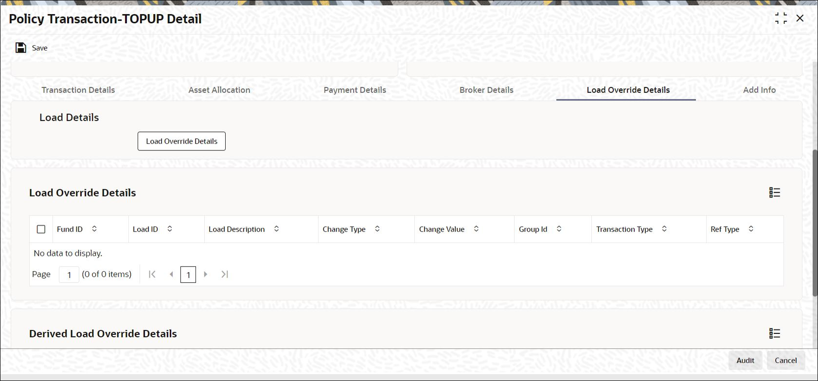

- On Policy Transaction-TOPUP Detail screen, click Load Override Details tab to override or alter the value of load mapped to the selected fund.The Load Override Details are displayed.
Figure 3-8 Policy Transaction-TOPUP Detail_Load Override Details Tab
- You can override or alter the value of load mapped to the selected fund. You can do so in the Load Override Details screen which is processed when you click on the Load Override Details Link.The following details are displayed:
- If you click Load Override Details button, the system defaults the load details.
- If you do not click this button, then the system will not default even if the fund has load. In this case, load will get computed during allocation only.
- On Load Override Details, specify the fields. For more information on fields, refer to the field description table.
