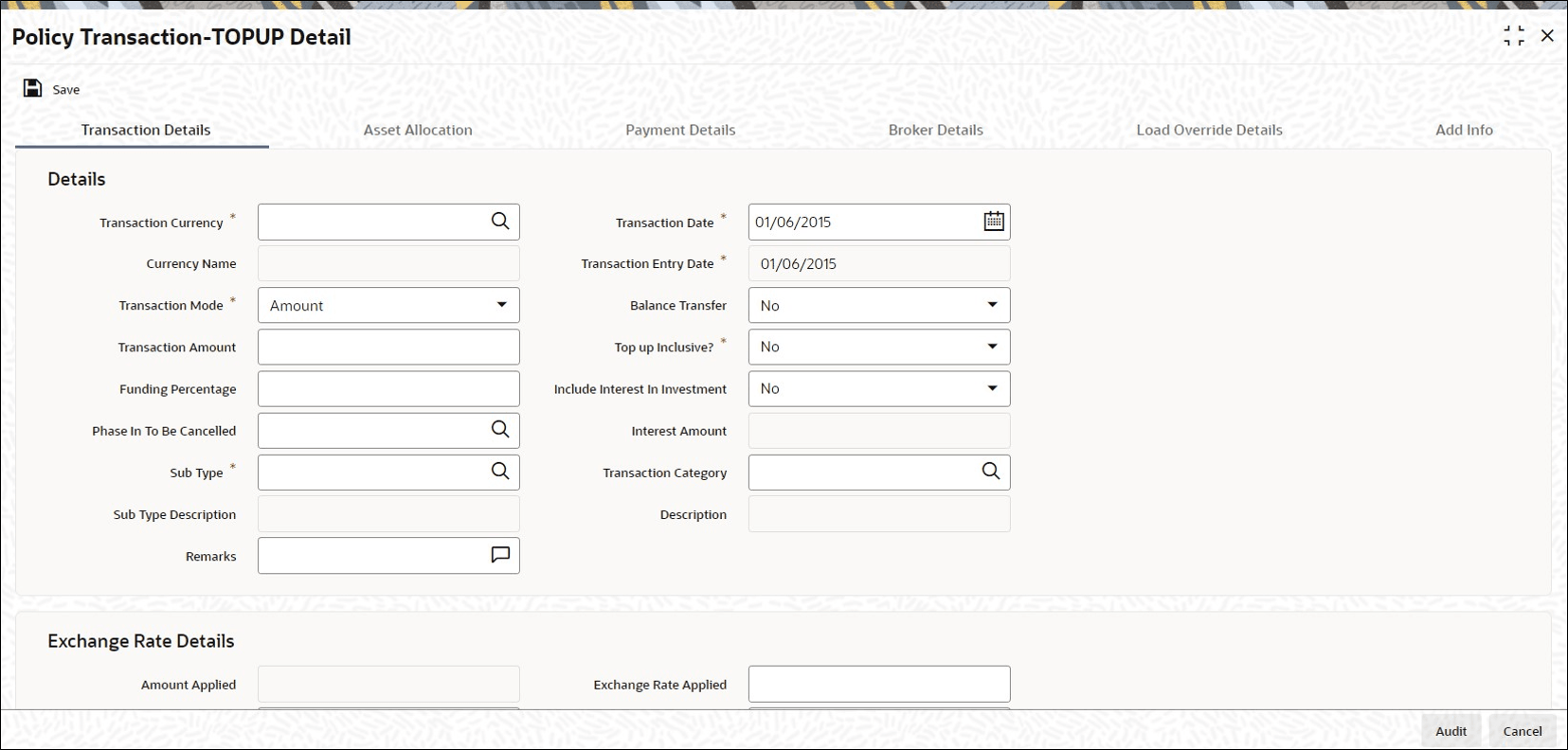

3.1.3 Transaction Details Tab
This topic explains the transaction details tab of Policy Transaction-TOPUP Detail screen.
- On Policy Transaction-TOPUP Detail screen, click Transaction Details tab.The Transaction Details are displayed.
Figure 3-4 Policy Transaction-TOPUP Detail_Transaction Details Tab
- On Transaction Details Tab, specify the fields. For more information on fields, refer to the field description table.
