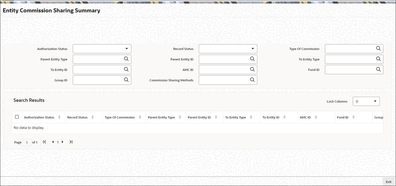

  1. On Home screen, type UTSENTCO in the text box, and click Next.
    The Entity Commission Sharing Summary screen is displayed.
    Figure 7-24 Entity Commission Sharing Summary
  2. On Entity Commission Sharing Summary screen, specify any or all of the following details in the corresponding fields:

  3. Click Search button to view the records.
    All the records with the specified details are retrieved and displayed in the lower portion of the screen.
