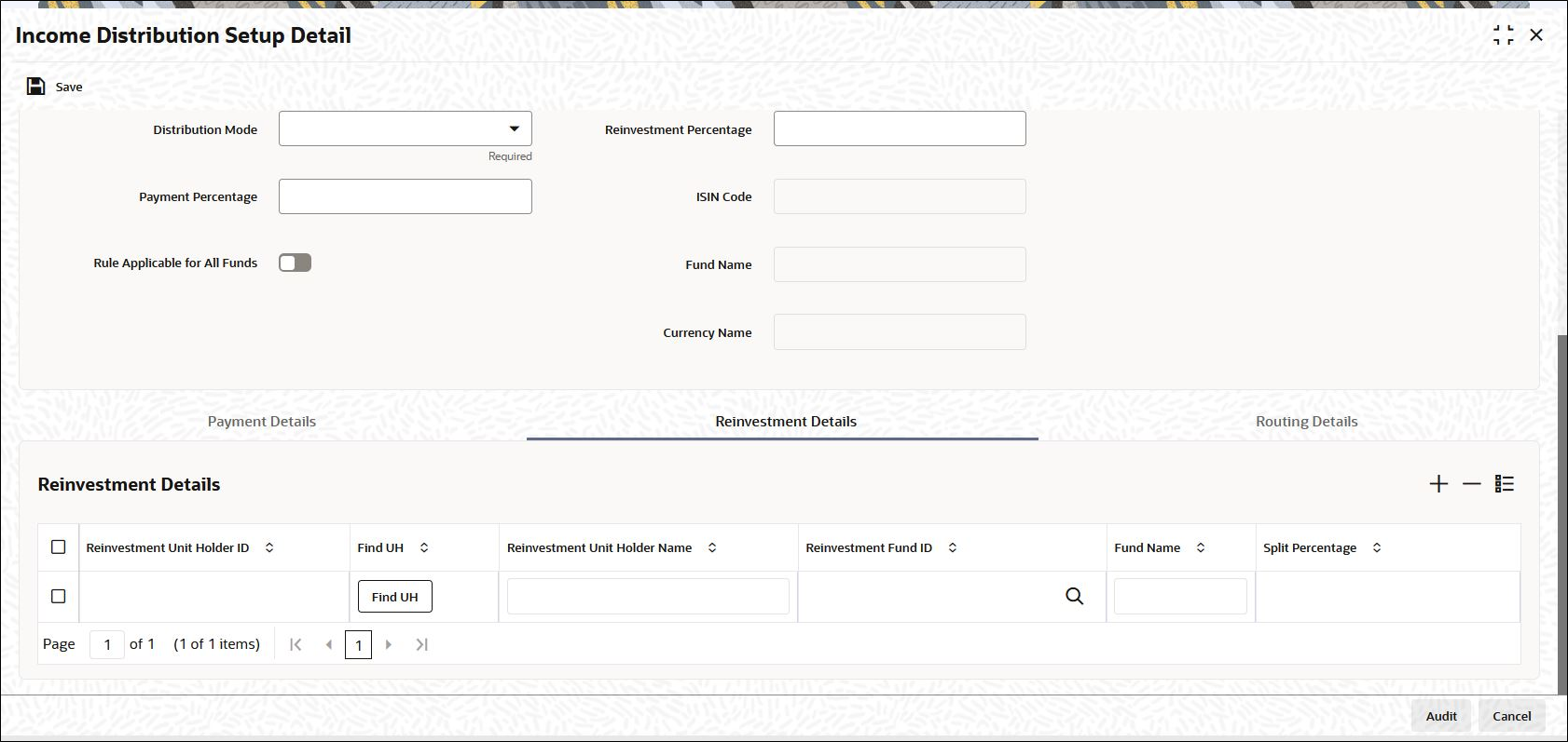

  1. On Income Distribution Setup Detail screen, click Reinvestment Details tab to capture the details.
    The Reinvestment Details are displayed.
    Figure 2-21 Income Distribution Setup Detail_Reinvestment Details Tab
  2. you can define the pattern in which the entity can reinvest income earnings back into the funds of the AMC.

  5. On Reinvestment Details Tab, specify the fields.
    Table 2-16 Reinvestment Details - Field Description
    Field Description
    Reinvestment Unit Holder ID
    Alphanumeric; 12 Characters; Mandatory
    Specify the ID of the unit holder in whose account the income is to be reinvested. When you select the ID of the reinvestment unit holder, the name of the unit holder is displayed in the Reinvestment Unit Holder Name field.
    The entity’s default Unit Holder ID is displayed here. If necessary, you can change it.
    You can also click Find UH button to query reinvestment unit holder ID.
    Display
    The system displays the name of the Unit Holder based on the Reinvestment Unit Holder ID.
    Reinvestment Fund ID Alphanumeric; 6 Characters; Mandatory
    Select the ID of the fund in which the income is to be reinvested.
    Fund Name Display
    The system displays name of the specified reinvestment fund based on the details maintained at Fund Maintenance level.
    Split Percentage Numeric; 5 Characters; Mandatory
    Specify the percentage of the derived income that is to be reinvested in the specified reinvestment unit holder's account, in the specified reinvestment fund. You can make any number of such entries, specifying a percentage for each combination. The sum total of all split percentages for all reinvestment unit holder – reinvestment fund ID combinations you have specified must be equal to one hundred percent.
