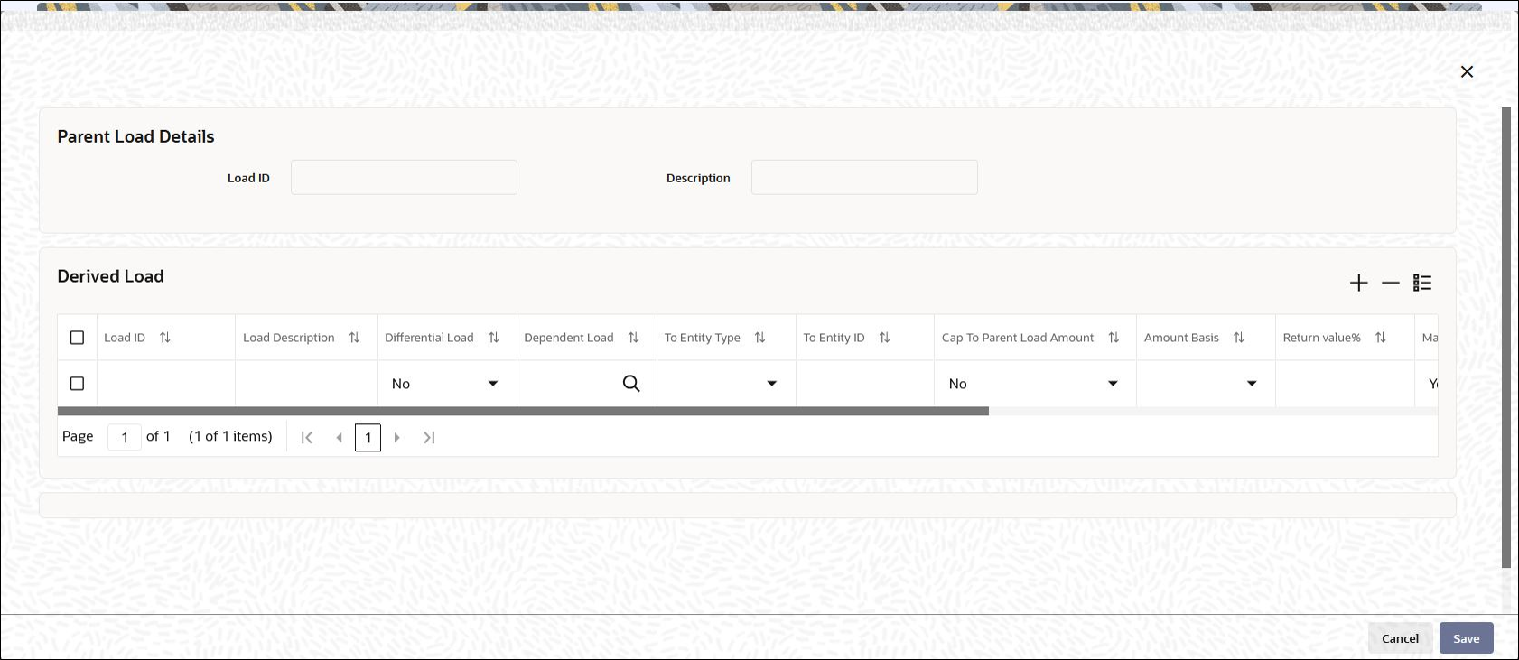

| Load ID | Display Only The ID of the Load to which the derived load that is being set up should be mapped, is displayed here, from the Load Definition screen. This is the parent load. |
| Description | Display The system displays the description of the load ID. |
| Derived Load Section | In this section, you may specify the parameters for a new derived load. Once you tab out of the last field in the row, (i.e. the Criteria field), the record is saved automatically. |
| Load ID | Numeric; 5 Characters; Mandatory Specify a unique alphanumeric identifier for the derived load. This ID must not be the ID of a load already existing in the system database. |
| Load Description | Alphanumeric; 60 Characters; Mandatory Enter some descriptive or narrative text, qualifying the derived load. It should describe the purpose for which the load has been set. |
| Differential Load | OptionalSelect the differential load status from the drop-down list. The list displays the following values: |
| Dependent Load | Alphanumeric; 6 Characters; Mandatory Specify the dependent load. |

| To Entity ID | Alphanumeric; 12 Characters; Optional Specify the ID of the entity to which this load is payable. This must be the ID of a valid entity in the system, and the load setup must be applicable for this entity type. |
| Cap to Parent Load Amount | Optional Select Yes to indicate that the derived load amount is to be capped to the parent load amount. If selected as Yes then the sum of derived load amounts cannot be greater than the parent load amount. If not, the net derived amount can be negative (that is, the resultant front end load for a particular entity could be negative). This specification is used for derived loads that are set up for the purpose of fee/commission sharing between the AMC and the Distributors. |
| Amount Basis | Optional In this field, you can indicate whether the derived load is a percentage of the parent load amount, or whether it is derived based on the transaction amount. Select either Gross or Net to indicate that the derived load is to be derived based on the transaction amount; leave this field blank to indicate that the derived load is a percentage of the parent load amount. This specification is used for derived loads that are set up for the purpose of fee/ commission sharing between the AMC and the Distributors. |
| Return Percentage | Numeric; 22 Characters; Optional Enter the load percentage that is applicable for this derived load. This value must be greater than zero and less than one hundred. |
| Mandatory | Optional Select Yes to indicate that the derived load is to be processed as a mandatory load. If you select No then the derived load is deemed to be an optional load. A mandatory derived load will be applied (or processed) based on the criteria setup for this load. An optional derived load will be applied based on the priority you assign to it, depending upon the priority number you specify in the Priority No. field in this screen. |
| Priority No. | Numeric; 22 Characters; Optional Specify the priority number that will indicate the priority of application for the derived load. |
