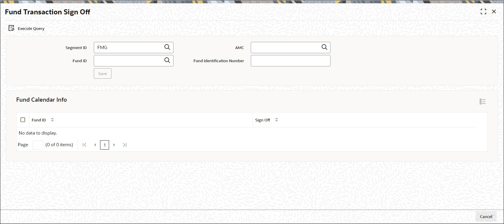

2.33 Perform Fund Transaction Sign Off
This topic provides the systematic instructions to mark the sign off status.
  1. On Home screen, type UTDTSOFF in the text box, and click Next.
    The Fund Transaction Sign Off screen is displayed.
    Figure 2-44 Fund Transaction Sign Off
  2. On Fund Transaction Sign Off screen, click New to enter the details.
    For more information on fields, refer to the field description below,
    Table 2-48 Fund Transaction Sign Off - Field Description
    Field Description
    Segment ID
    Alphanumeric; 12 Characters; Optional
    Specify the Segment ID. Alternatively, you can select the Segment ID from the option list. The list displays all valid Segment ID maintained in the system.
    Note: Segment ID is mandatory in Global Transfer Agency(GTA) Setup. In Non GTA Setup, Segment ID will be defaulted to value FMG.
    Fund ID
    Alphanumeric; 6 Characters; Optional
    Specify the Fund ID.
    AMC Display
    The system displays the description for the selected Fund ID.
    Execute Query
    Click Execute Query button after specifying Fund ID. The following fund calendar information is displayed:
    • Fund ID
    • Sign Off
    Fund Identification Number Display
    The system displays the Fund Identification Number.
Trading Transactions
