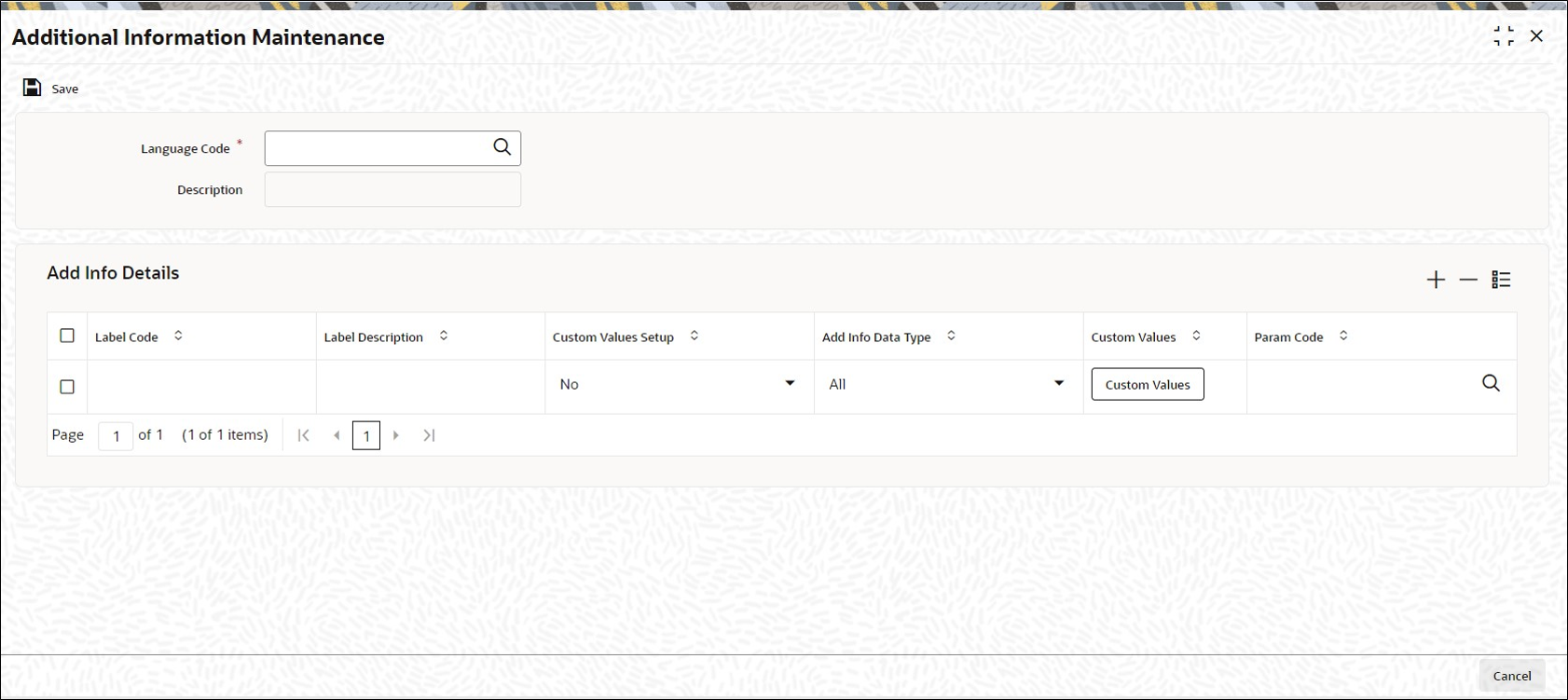

This topic provides the systematic instructions to define additional information pertaining to any entities that you set up in the system.

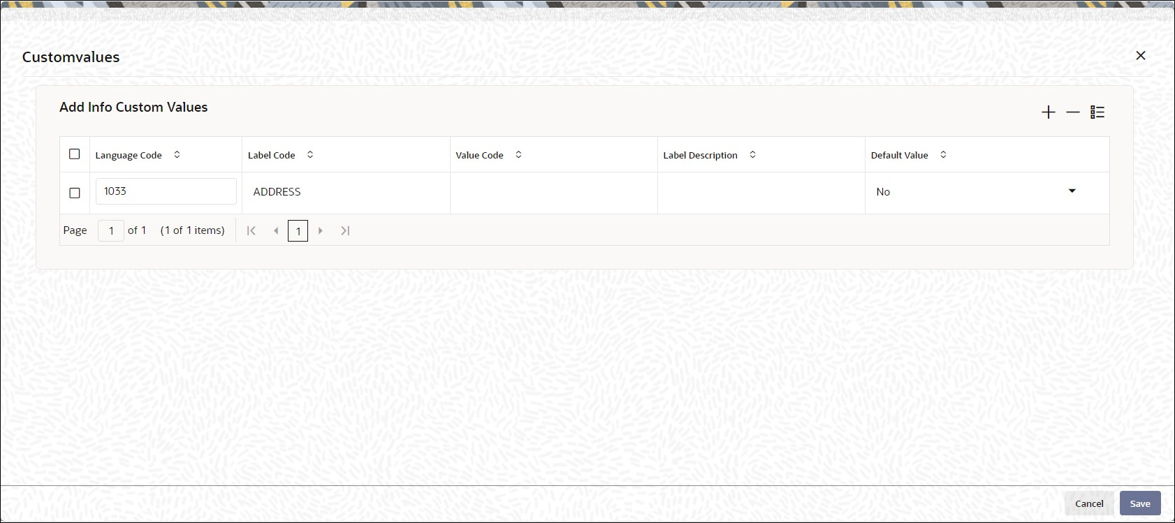

The Oracle® FLEXCUBE Investor Servicing system gives you the facility of defining heads under which you can capture any additional information pertaining to any entities that you set up in the system, especially unit holders and brokers. You can also set up a list of acceptable, valid values for each information head.
Use Additional Information Maintenance screen to define these additional information heads and their valid values.
