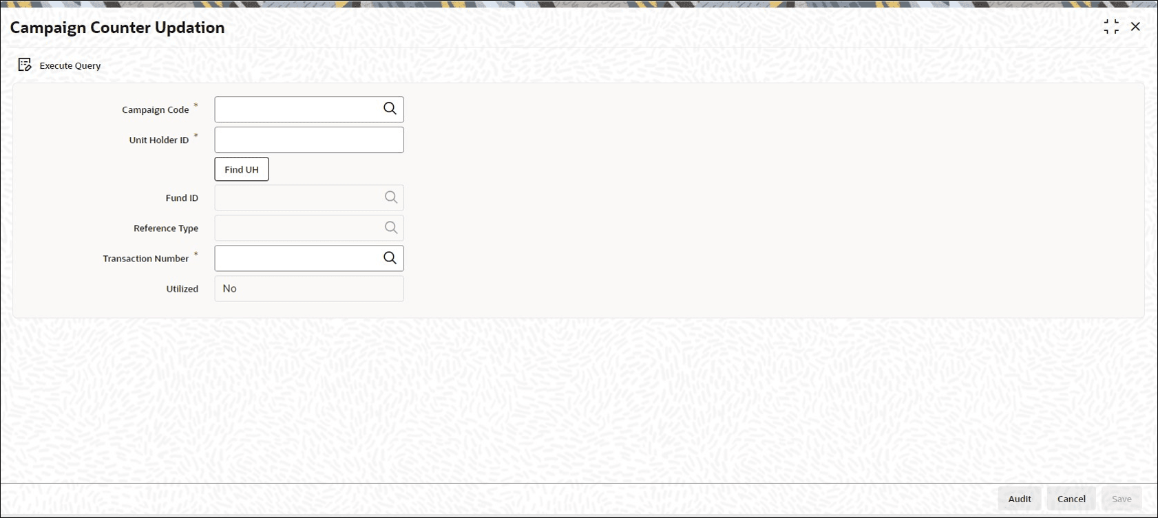

- On Home screen, type UTDCMPUP in the text box, and click Next.The Campaign Counter Updation screen is displayed.
- On Campaign Counter Updation screen, click New to enter the details.For more information on fields, refer to the field description table.
Table 7-34 Campaign Counter Updation - Field Description
Field Description Campaign Code Alphanumeric; 10 Characters; Mandatory Specify the campaign code. Alternatively, you can select campaign code from the option list. The list displays all valid campaign code maintained in the system.
Unit Holder ID Alphanumeric; 12 Characters; Mandatory Specify the unit holder ID. Alternatively, you can select unit holder ID from the option list. The list displays all valid unit holder ID maintained in the system.
Click Find UH button to fetch unit holder details.
Fund ID Display The system displays the fund ID.
Reference Type Display The system displays the reference type.
Transaction Number Alphanumeric; 16 Characters; Mandatory Specify the transaction number. Alternatively, you can select transaction number from the option list. The list displays all valid transaction number maintained in the system.
Utilized Optional Select if the campaign should be re-used again for the unit holder from the drop-down list. The list displays the following values:- Yes
- No
You can reuse a campaign for a particular transaction number by selecting Utilized field as
No. The system will in turn update the benefit counter in the campaign.
