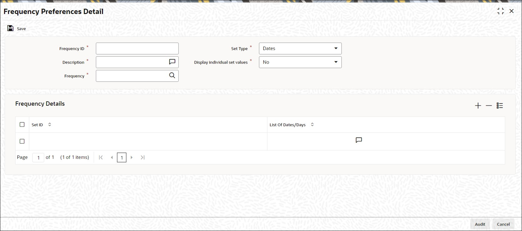

This topic provides the systematic instructions to define setup of dates / days that can be used for mapping in Fund rules and Standing Instructions.
- On Home screen, type UTDFRQPR in the text box, and click Next.The Frequency Preferences Detail screen is displayed.
- On Frequency Preferences Detail screen, click New to enter the details.For more information on fields, refer to the field description table.
Table 2-60 Frequency Preferences Detail - Field Description
Frequency Available values for each frequency Frequency ID Alphanumeric; 10 Characters; Mandatory Enter a unique ID for the setup.
Description Alphanumeric; 255 Characters; Mandatory Specify the description of the setup.
Frequency Alphanumeric; 1 Character; Mandatory Specify the frequency. Alternatively, you can select frequency code from the option list. The list displays all valid frequency code maintained in the system.
Set Type Mandatory This is applicable only if frequency selected is Weekly. The Applicable values being either Dates or Days.
For other frequencies, it would be defaulted to Dates and you will not be allowed to change it.
Display individual set values Display The system automatically derives Display Individual Set Values based on the Frequency and Set Type selected.
If you have selected Frequency as Weekly, then you can select Set Type as
DatesorDays.The logic of Display individual set values derived by the system is as follows:- If the Frequency is
weeklyand set type is DATE, the Display individual set values should beNO - If the Frequency is
weeklyand set type is DAY, the Display individual set values should beYES - If the Frequency is
Fortnightlyand set type is DATE, the Display individual set values should beNO - If the Frequency is
Monthlyand set type is DATE, the Display individual set values should beYES/NO(only one value in one SET so functionally no use). - If the Frequency is
Quarterlyand set type is DATE, the Display individual set values should beYES/NO(only one value in one SET so functionally no use).
Frequency Details The section displays the following fields. Set ID Alphanumeric; 10 Characters; Mandatory Specify the unique ID for this set depending on the frequency specified.
Note: If Set ID is already mapped to the SI, you cannot delete the same during amendment. This will be checked by looking at the funds that are mapped to the Frequency ID for which SI has been setup for a particular Set ID.
List Of Dates/Days Alphanumeric; 255 Characters; Mandatory Specify the dates or days based on the Set Type.
If the client country parameter is set to SIRULEATFREQ for your bank.Refer Annex_A.doc for further details.
