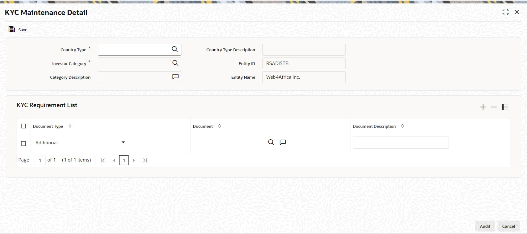

  1. On Home screen, type UTDKYCMT click New to enter the details.
    The KYC Maintenance Detail screen is displayed.
    Figure 2-60 KYC Maintenance Detail
  2. On KYC Maintenance Detail screen, click New to enter the details.
    Table 2-58 KYC Maintenance Detail - Field Description
    Field Description
    Country Type
    Alphanumeric; 1 Character; Mandatory
    In FCIS, countries are categorized into four types;
    • Financial Action Task Force (FATF)
    • Non FATF
    • NCCT
    • CRRT
    FATF is an inter-governmental body for developing and promoting policies to combat money laundering.
    Select FATF if you wish to maintain list of required KYC documents for investor account residing in a FATF country. Else, select Non FATF.
    Country Type Description Display
    The system displays the description for the selected country type.
    Investor Category Alphanumeric; 2 Characters; Mandatory
    Select the category of investor for whom the list of required KYC documents is to be set up, from the list.
    Category Description Display
    The system displays the description for the selected investor category.
    Entity ID Display
    The system defaults the Entity ID linked to the selected country type.
    Entity Name Display
    The system defaults the corresponding name of the defaulted entity here.
    KYC Requirement List
    The section displays the following fields.
    Document Type Optional
    You can either classify documents as Standard or as Additional.
    Document Alphanumeric; 255 Characters; Mandatory
    Specify the document name.
    Document Description Display
    The system displays document description for the selected document.
