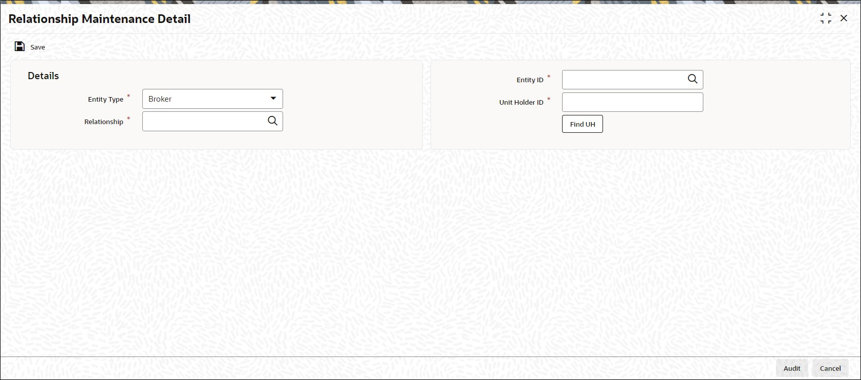

  1. On Home screen, type UTDENTRL in the text box, and click Next.
    The Relationship Maintenance Detail screen is displayed.
    Figure 2-18 Relationship Maintenance Detail
  2. On Relationship Maintenance Detail screen, click New to enter the details.
    Table 2-13 Relationship Maintenance Detail - Field Description
    Field Description
    Entity Type
    Mandatory
    Select the type of entity from the drop-down list. The list displays the following values:
    • Broker
    • Unit Holder
    Relationship
    Alphanumeric; 2 Characters; Mandatory
    Specify the relationship status. Alternatively, you can select relationship status from the option list. The list displays all valid relationship status maintained in the system.
    Entity ID Alphanumeric; 12 Characters; Mandatory
    Specify the entity ID. Alternatively, you can select entity ID from the option list. The list displays all valid entity ID maintained in the system.
    Unit Holder ID Alphanumeric; 12 Characters; Mandatory
    Specify the unit holder ID.
  3. Click Find UH button to inquire for unit holder ID.
