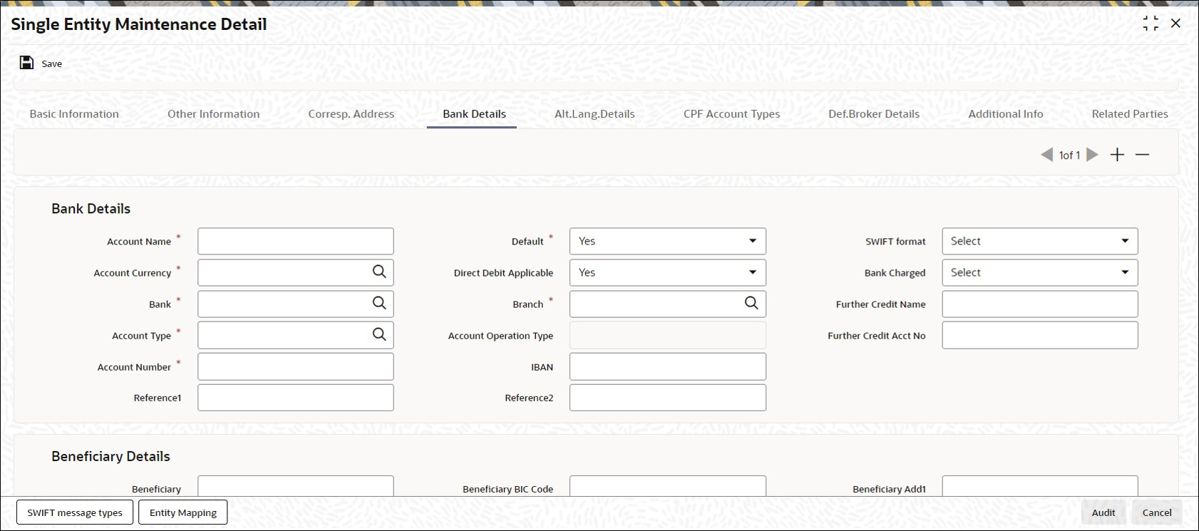

  1. On Single Entity Maintenance Detail screen, click Bank Details tab to capture the bank details.
    The Bank Details are displayed.
    Figure 2-7 Single Entity Maintenance Detail_Bank Details Tab
  2. On Bank Details Tab, specify the fields.
