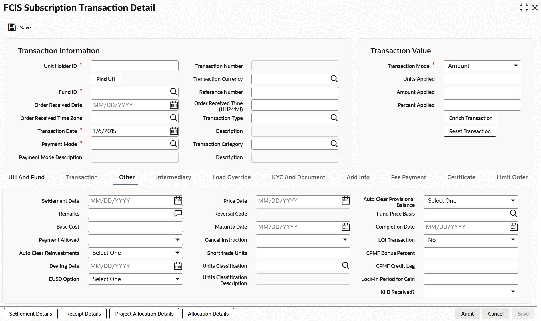

- On the FCIS Subscription Transaction Detail screen, click Other tab to enter the details.The Other details are displayed.
Figure 3-27 FCIS Subscription Transaction Detail - Other
- On Other screen, specify the fields.For more information on fields, refer to the field description below,
