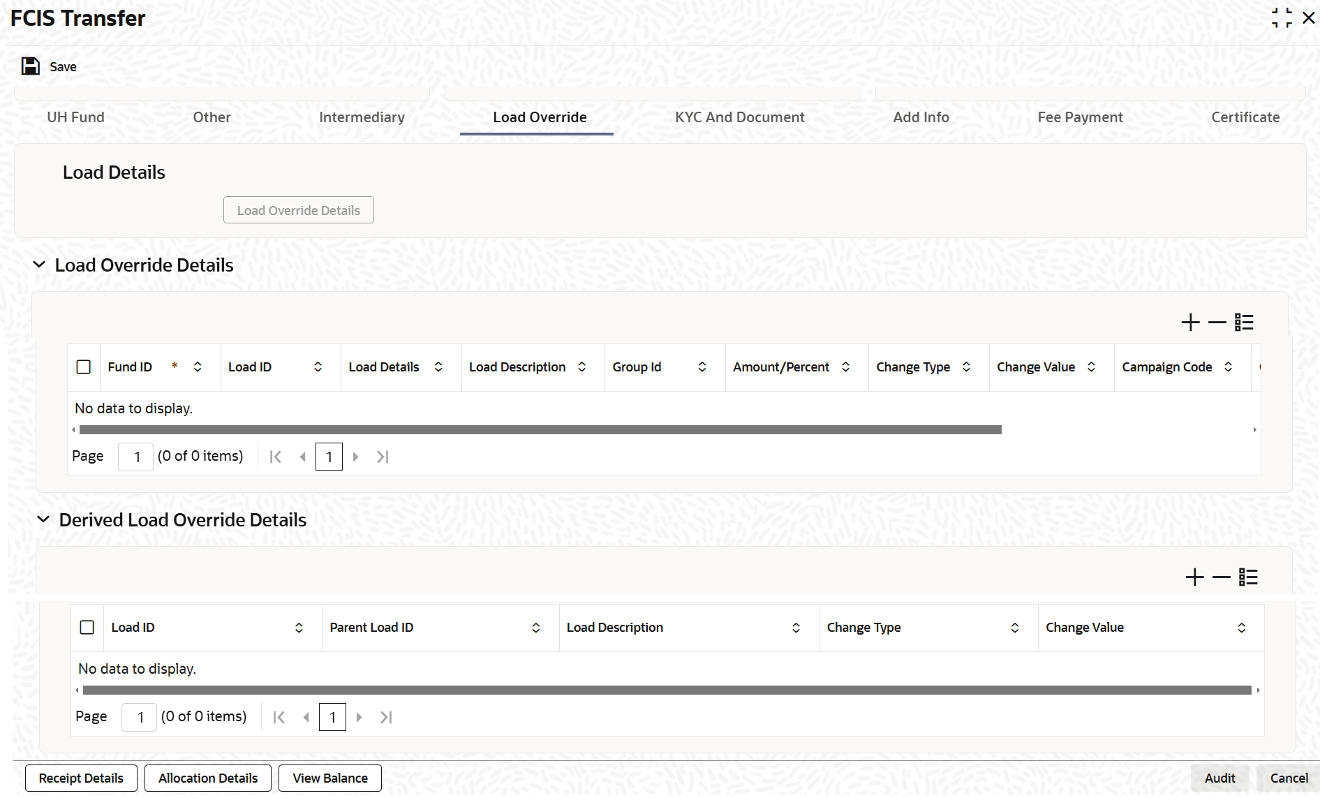

This topic explains the Load Override tab in the FCIS Transfer screen.
- On the FCIS Transfer screen, click Load Override tab to enter the details.The Load Override details are displayed.
- On Load Override tab, specify the fields.For more information on fields, refer to the field description table.

- You can override or alter the value of any load (including derived loads, if any) mapped to the selected fund and applicable for the transaction type, which is to be computed at the time of allocation in this section. The frequency of computation for such loads would be Allocation. This section is only enabled for funds that have allocation time loads mapped to them as applicable for the transaction type.
- Click the Load Override Details button to view Load Override details.
If you click this button, the system defaults the load details.
If you do not click this button, then the system will not default even if the fund has load. In this case, load will get computed during allocation only.
- You can view the following details in the Derived Load Override Details section.The following details are displayed.
- Load ID
- Parent Load ID
- Load Description
- Change Type
- Change Value
