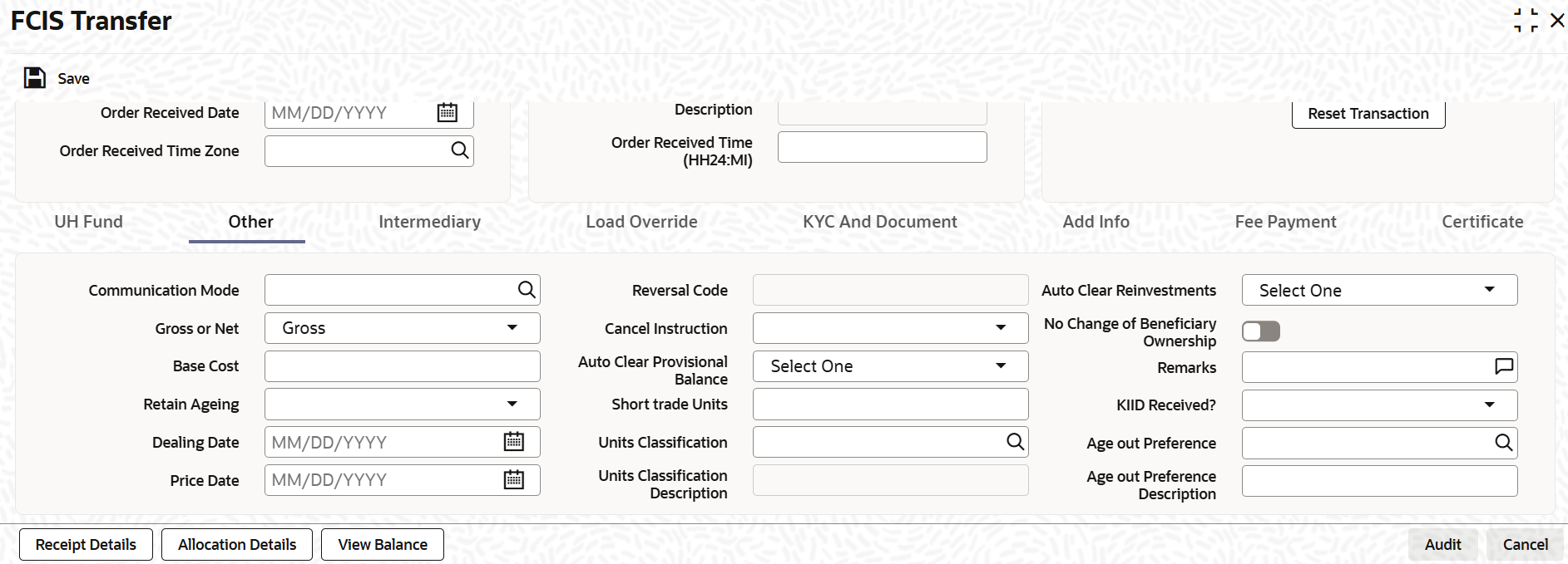

This topic explains the Other tab in the FCIS Transfer screen.
- On the FCIS Transfer screen, click Other tab to enter the following details.The Other details are displayed.
- On Other tab, specify the fields.For more information on fields, refer to the field description table.
Table 3-108 FCIS Transfer - Other
Field Description Communication Mode Alphanumeric; 2 Characters; Mandatory Specify the communication mode through which the transaction request was communicated. Alternatively, you can select mode of communication from the option list. the list displays all valid communication mode maintained in the system.

Dealing Date Date Format; optional By default, the dealing date is derived based on the dealing date maintained for the fund in the Specific Fund Price Date Setup screen. The date displayed here can be altered, if required, and you can specify the requisite dealing date. Dealing date will not be displayed on the screen if it is not maintained for a fund or the fund is not a specific price date fund. System will default the transaction date as the dealing date.
