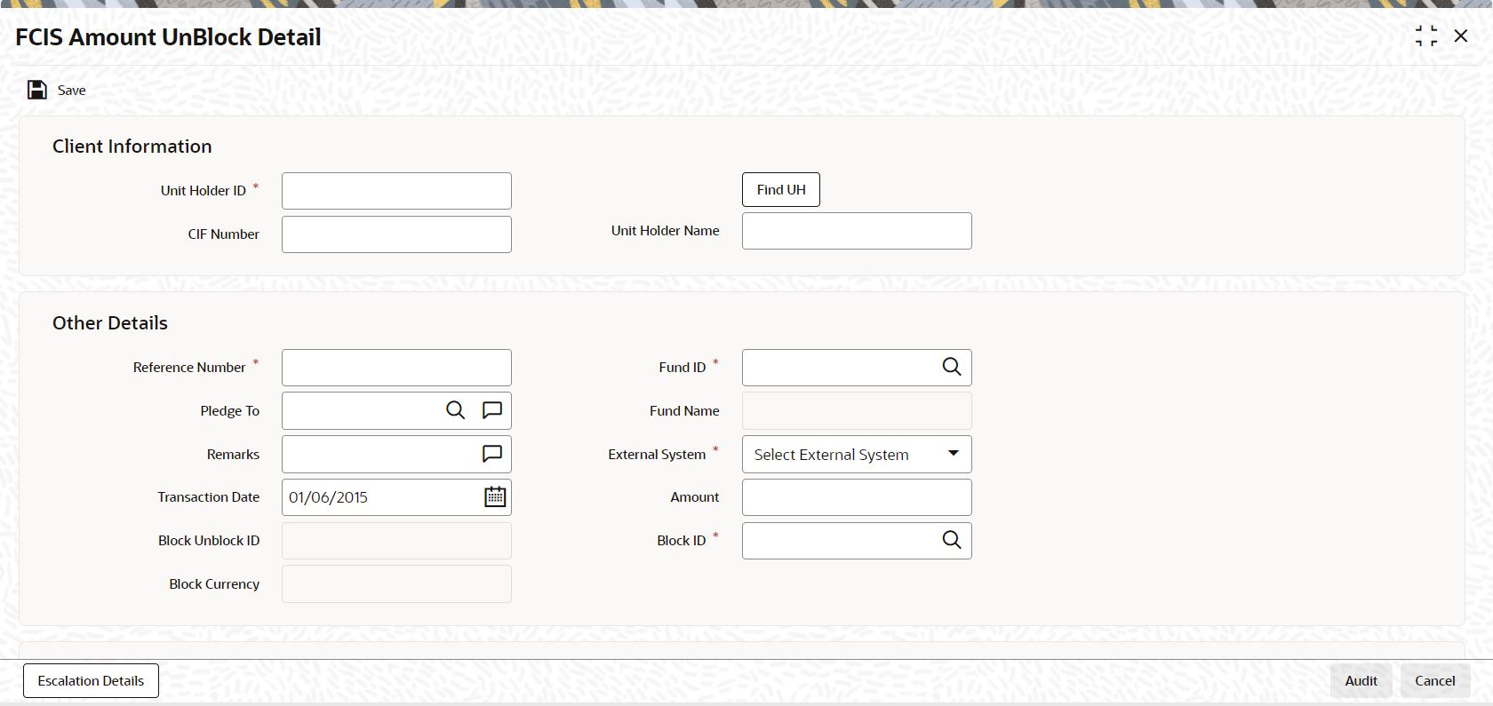

- On Home screen, type UTDAMT07 in the text box, and click Next.The FCIS Amount UnBlock Detail screen is displayed.
- On FCIS Amount UnBlock Detail screen, specify the fields.The FCIS Amount UnBlock Detail screen is displayed.To enter an amount block or unblock transaction in the detail screen,
- Specify the CIF to which the unit holder for whom the transaction is being entered belongs. Then select the unit holder account.
- If you are unblocking against a previously blocked amount transaction, specify the date of the unblocking transaction.
- Specify a unique reference number for the transaction.
- If you are entering a block transaction, specify the pledgor, if any, to whom the amount is pledged.
- Specify the amount to be blocked or unblocked for the transaction.
- If you are unblocking against a previously blocked amount transaction, specify the fund from which the units may be redeemed.
- Specify any relevant details of escalation for the amounts, as well as any payment details (for the redemption of units due to unblocking)
- Click Ok button to save the transaction.

- On the FCIS Amount UnBlock Detail screen, specify the fields.
For more information on fields, refer to field description table.
Table 5-25 FCIS Amount UnBlock Detail - Client Information
Field Description Unit Holder ID Alphanumeric; 12 Characters; Mandatory Select the unit holder for whom the transaction request is being entered. You can query for unit holder ID by selecting the Find UH button.
Unit Holder Name Display The system displays the name of the selected unit holder ID.
CIF Number Alphanumeric; 20 Characters; Mandatory If the unit holder that has requested for the transaction is attached to a CIF Customer, specify the number of the CIF customer in this field. The system retrieves the name of the CIF customer and displays it alongside this field.
If you specify the unit holder ID details, then the system displays the CIF number and vice versa.

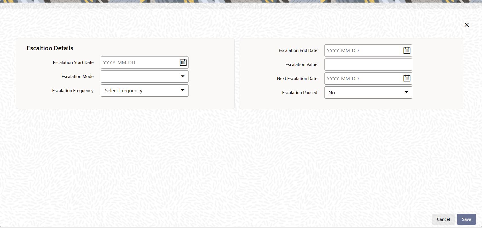

- On FCIS Amount UnBlock Detail screen, click Escalation Details button.The Escalation Details screen is displayed.
Sometimes an investor may instruct the AMC to increase the blocked or unblocked amounts at pre-defined intervals. Such increase patterns are termed as escalation details.
You can maintain the pattern of escalation for the amount block or unblock transaction.Note:
This is optional, but if you make an entry in any field here, then all the other fields will be mandatory and you must then make your specifications in all the fields.
Table 5-30 Escalation Details
Field Description Escalation Start Date Date Format; Optional Specify the date on which the first increase or first escalation must occur. Beginning from this date, the blocked (or unblocked) amount will be increased as specified, at intervals determined by the pre-defined frequency that you specify in the Escalation Frequency field.
Escalation End Date Date Format; Optional Specify the date on which the last increase or escalation must occur.
The start date and end date taken together signify a period during which escalation of the blocked (or unblocked) amount will occur at the frequency that you define in the Escalation Frequency field.
Escalation Mode Optional Select whether the increase is an amount-based escalation or percentage escalation the drop-down list. The list displays the following values:- Amount
- Percentage
Escalation Value Numeric; 30 Characters; Optional Enter the value by which the blocked (or unblocked) amount must be increased. At each instance when the escalation comes into effect, the blocked amount will be increased by this value.
Escalation Frequency Optional Select the frequency at which the escalation must occur from the drop down list. The list displays the following values:- Daily
- Weekly
- Bi-Weekly
- Monthly
- Quarterly
- Half-Yearly
- Yearly
Next Escalation Date Date Format; Optional Specify the date on which the next escalation will take place. For records retrieved in the Amend mode, this date may be altered in the amend session.
Escalation Paused Optional If you want the escalation to be halted for a while or a hiatus to occur, then select Yes from the drop-down list. Else select No.
