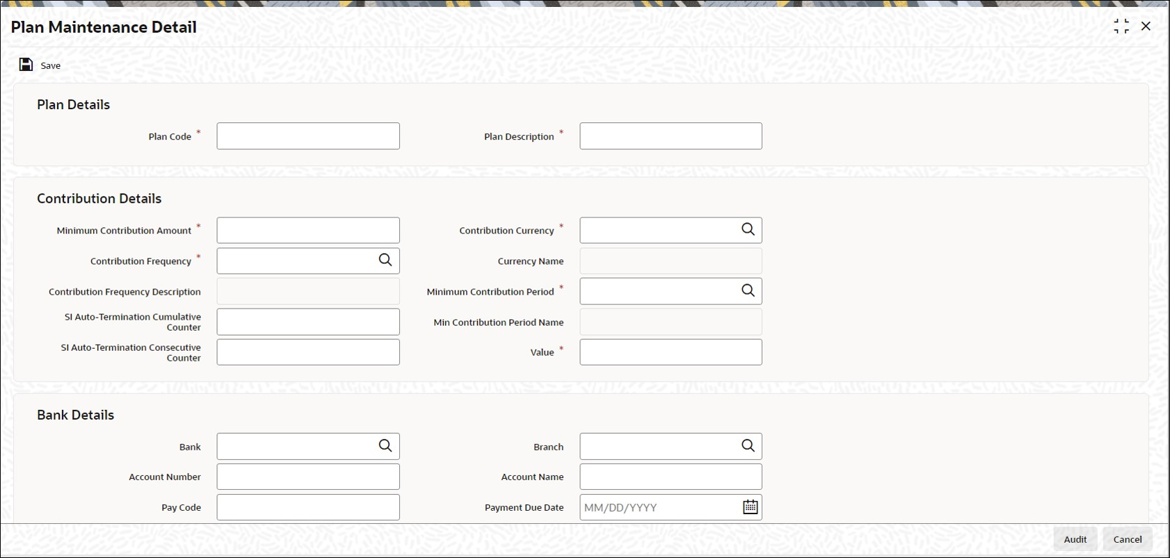

  1. On Home screen, type UTDRSPM in the text box and click Next.
    The Plan Maintenance Detail screen is displayed.
    Figure 1-16 Plan Maintenance Detail
  2. On Plan Maintenance Detail screen, specify the fields.
    Table 1-36 Plan Maintenance Detail - Field Description
    Field Description
    Plan Code Alphanumeric; 6 Characters; Mandatory
    Provide a unique identification for the new template you are creating, in this field.
    Plan Description Alphanumeric; 60 Characters, Mandatory
    Enter descriptive text, a short phrase that qualifies the plan.
