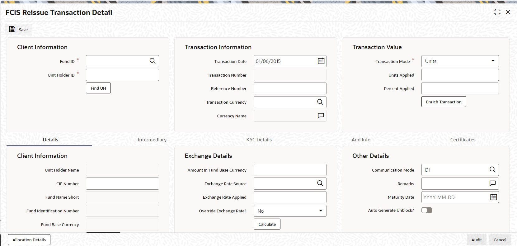

This topic provides the instructions to enter a block transaction request into the system.
- On Home screen, type UTDTXN10/UTDTRA10 in the text box and click Next.The FCIS Reissue Transaction Detail screen is displayed.
Figure 3-136 FCIS Reissue Transaction Detail
- On FCIS Reissue Transaction Detail screen, specify the fields.For information on fields in the screen, refer the below table.

- Click the Enrich Transaction button after entering all details in Transaction Information section.The list of transactions applicable for the Unit Holder selected is defaulted in UH and Fund section.
