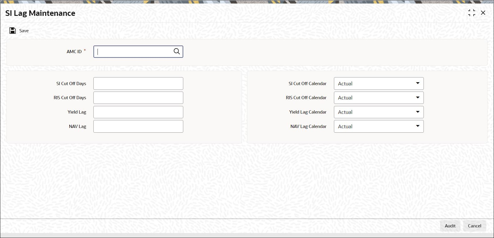

  1. On Home screen, type UTDSILAG in the text box and click Next.
    The SI Lag Maintenance screen is displayed.
  2. On SI Lag Maintenance screen, specify the fields.
    For more information on fields, refer to the field description below,
