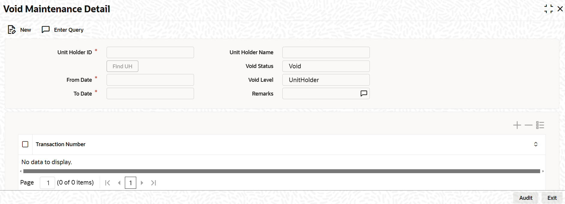

- On Home screen, type UTDVOID in the text box, and click Next.The Void Maintenance Detail screen is displayed.
- On Void Maintenance Detail screen, specify the fields.For information on fields in the screen, refer the below table.
Table 4-22 Void Maintenance Detail
Fields Description Unit Holder ID Alphanumeric; 12 Characters; Mandatory Specify the unit holder ID. You can also click on ‘Fund UH’ button to select the valid unit holder ID.
Unit Holder Name Display The system displays the unit holder name for the selected unit holder ID.
From Date Date Format; Mandatory Select the date from when the void details needs to be maintained from the adjoining calendar.
To Date Date Format; Select the date till when the void details needs to be maintained from the adjoining calendar.
Void Status Optional Select the void status the drop-down list. The list displays the following values:
- Void
- Un-Void
Void Level Optional Select the void status the drop-down list. The list displays the following values:
- UnitHolder
- Transaction
Remarks Alphanumeric; 255 Characters; Optional Specify remarks, if any
Transaction Number Alphanumeric; 16 Characters; Optional Specify the transaction number, Alternatively, you can select transaction number from the option list. The list displays all valid transaction number maintained in the system.
