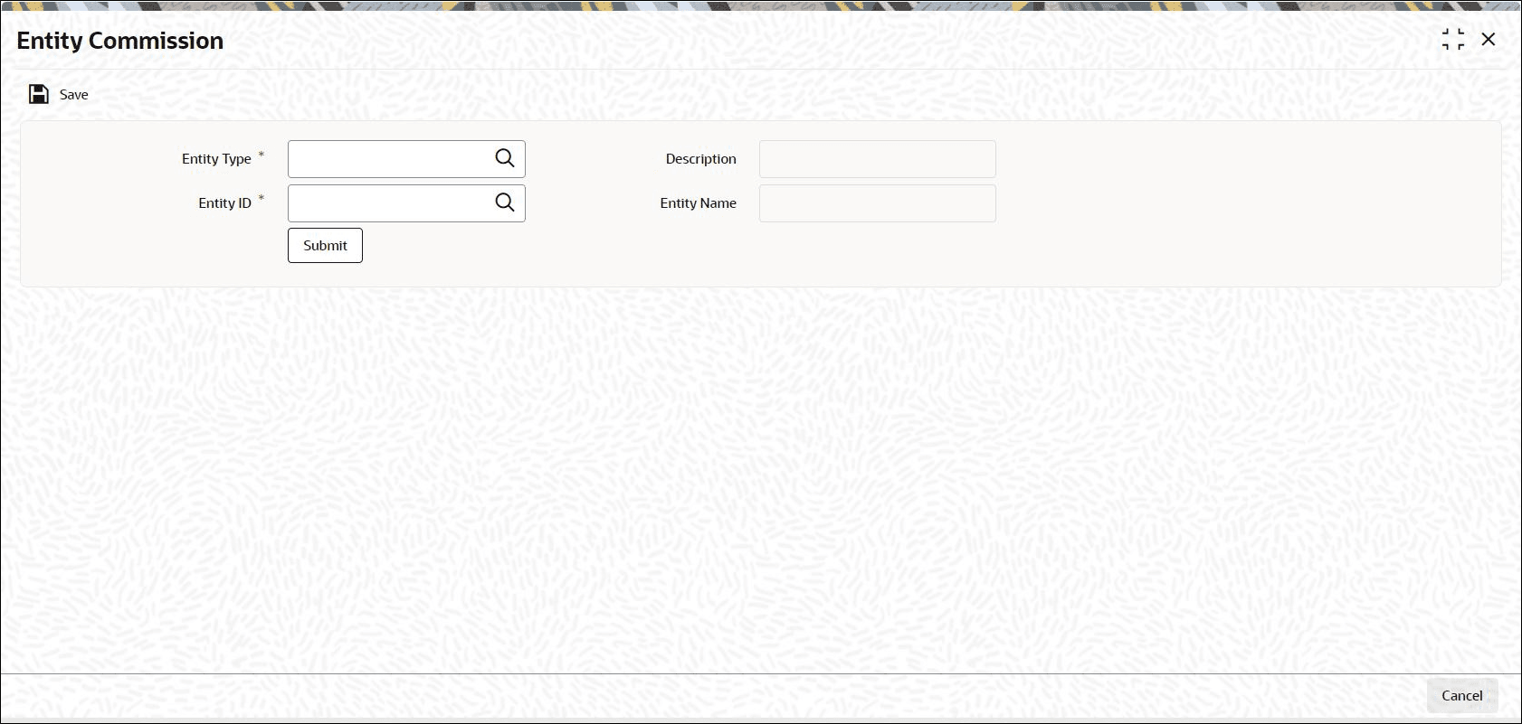

  1. On Home screen, type UTDECPYP in the text box, and click Next.
    The Entity Commission screen is displayed.
  2. Enter the details of the entity for which you wish to process the commission payments.
    Entity commission payments are processed only for those entities for which the Entity Payment Details have been maintained, even if entity commission has been accrued.
  3. On Entity Commission screen, click New to enter the details.
    Table 1-18 Entity Commission - Field Description
    Field Description
    Entity Type Alphanumeric; 1 Character; Mandatory
    Specify the entity type.
    Description Display
    The system displays the description for the selected entity type.
    Entity ID Alphanumeric; 12 Character; Mandatory
    Specify the entity ID.
    Entity Name Display
    The system displays the entity name for the selected entity ID.
