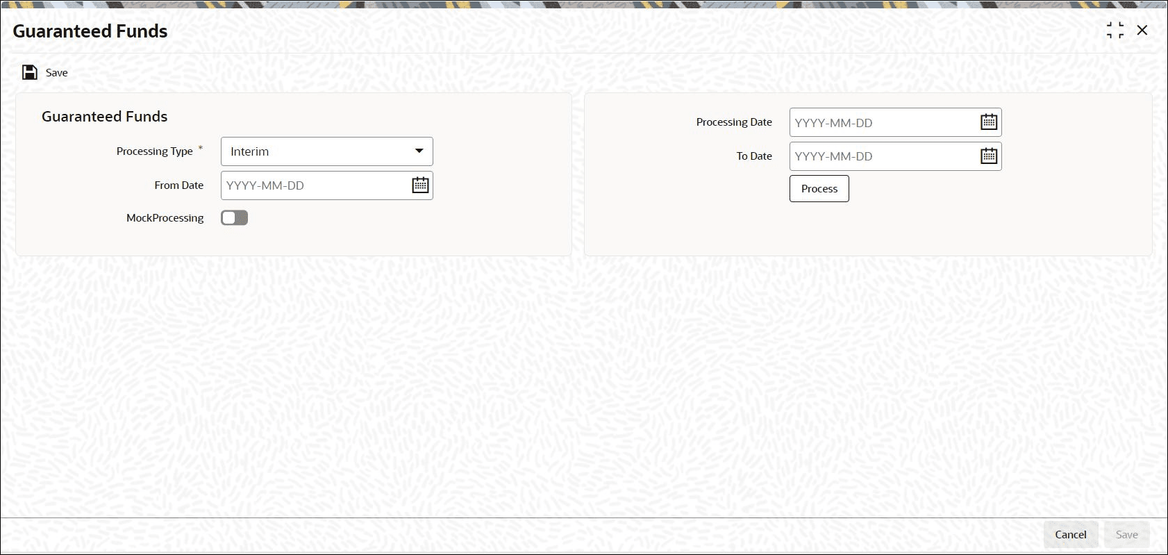

- On Home screen, type UTDUFUND in the text box, and click Next.The Guaranteed Funds screen is displayed.
- On Guaranteed Funds, click New to enter the details.For more information on fields, refer to the field description table.

Field Description Processing Type Mandatory Select whether the batch processing is Interim or Year End Processing from the drop-down list. The list displays the following values:
- Interim
- Final
Processing Date Date Format; Mandatory Select the processing date from the adjoining calendar.
From Date and To Dates Date Format; Mandatory Enter the period for which the price revision is applicable.
Mock Processing Optional Check this box if you require the system to carry out a Simulation (Mock GF correction) run. The Simulation run is possible on an Interim as well as Year End basis.
The system uses the Mock GF Fund Price for its calculations during these runs. After the successful completion of a Simulation run, the system generates a 16- digit Batch number that you can use for reporting purposes. If you leave the box unchecked, the system treats the run as an Actual run and uses the Actual GF Fund Price.
Note:- The system does not generate the policy related transaction for a policy holder, if you have checked the Mock Processing option.
- In the case of investors who have left before the final run occurs, the system does not create any adjustment entries during the Mock GF final run. It indicates the number of units that is to be shared proportionately among existing investors only at the time of the actual final run.
- The bulk fund price upload for Mock (simulation) run and actual run has to be done separately and two separate interfaces should be maintained for the same.
- Click the Process button to execute the batch
