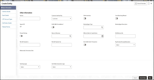

2.3.3 Other Information
This topic explains the Other Information section in the Basic Information tab of Create Entity screen.
  1. On Create Entity screen, click Basic Information tab to enter the other information details.
    The Other Information details are displayed.
  2. On the Other Information tab, specify the fields.
