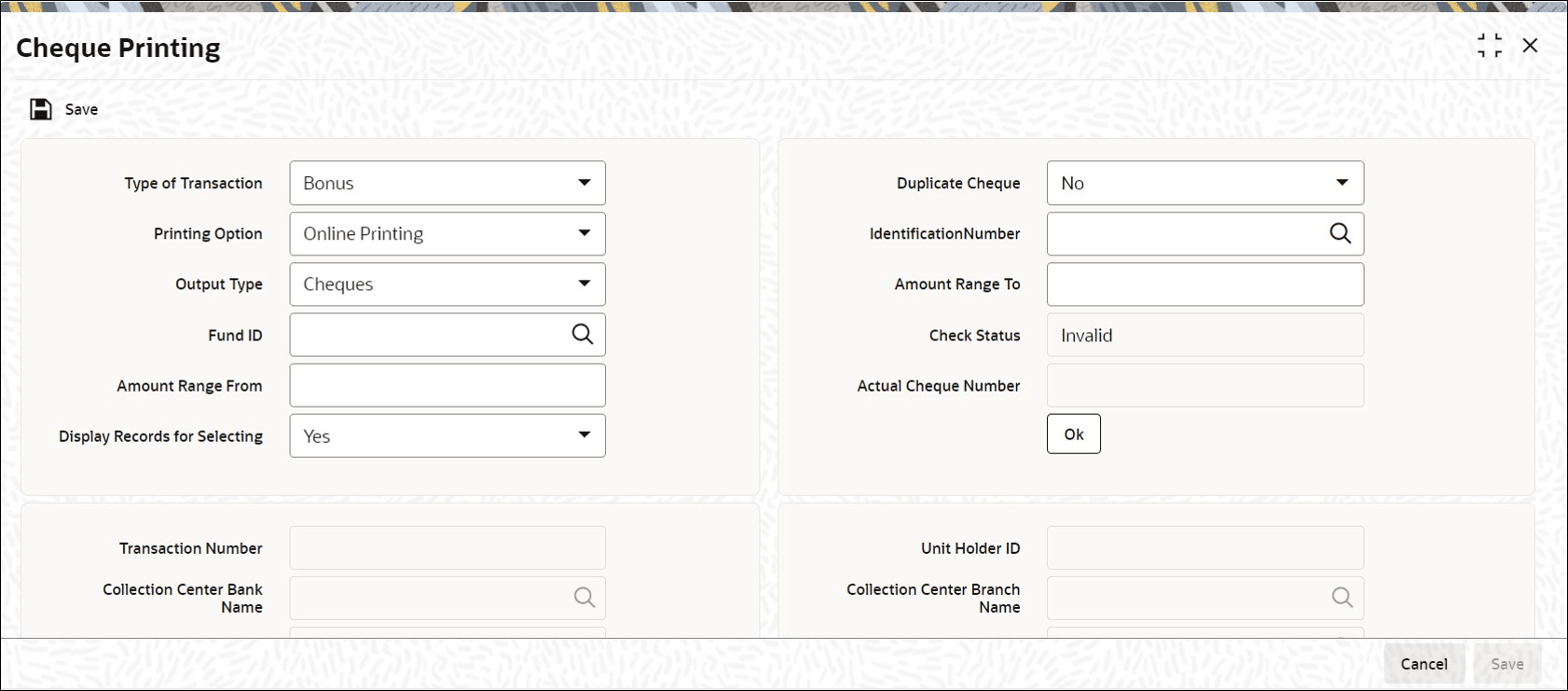

This topic provides the systematic instructions to initiate the printing of checks for any of the payments.
- On Home screen, type UTDCHKPR in the text box, and click Next.The Cheque Printing screen is displayed.
- Initiate the printing of dividend cheques after a corporate action dividend of any type is declared and authorized in the system.You can also print covering letters for the dividend.
- Initiate the printing of the cheques for the redemption payout when a redemption transaction in the system has been allocated.
- Initiate printing cheques for payment of fees or incentives that would be levied.
- Print pay-in slips containing details of payment made towards subscription or IPO transactions, to be sent to appropriate collection centres.
- Perform the data extraction for any kind of payment instrument or pay-in slip in the Data Extraction screen before you attempt to actually print the instrument in this screen.
- On Cheque Printing screen, click New to enter the details.For more information on fields, refer to the field description table.
