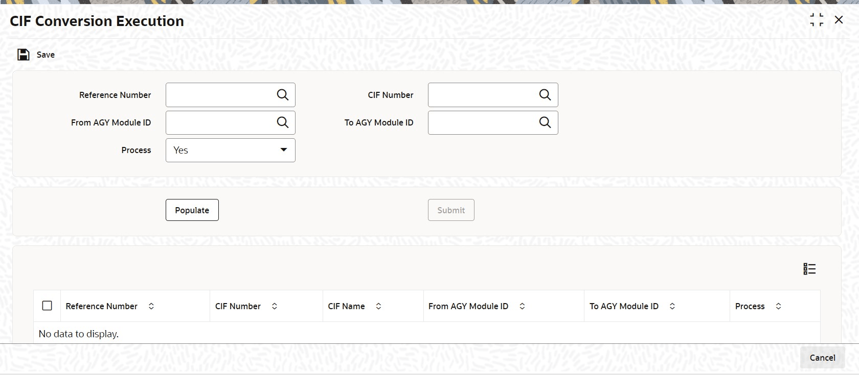

  1. On Home screen, type UTDCIFEX in the text box, and click Next.
    The CIF Conversion Execution screen is displayed.
    Figure 1-30 CIF Conversion Execution
  2. On CIF Conversion Execution screen, click New to enter the details.

  3. Click the Populate button. You can specify any of the above filter criteria.
  4. CIF conversion records having status as Ready for Conversion and Conversion Failure will be eligible for listing in this screen.
