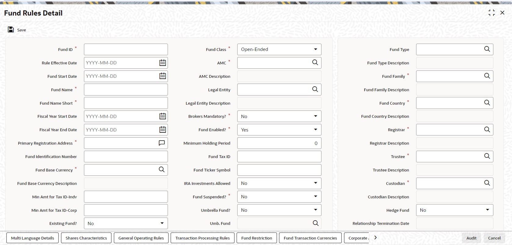

To set up the Fund Demographics profile for a fund, use the Fund Demographics screen.
  1. On Home screen, type UTDFNDRL in the text box and click Next.
    The Fund Rules Detail screen is displayed.

  2. On Fund Rules Detail screen, specify the fields.
    For more information on fields in the screen, refer the below table.
    Table 2-2 Fund Rules Detail
    Field Description
    Fund ID Alphanumeric; 6 Characters; Mandatory
    The Fund ID is a unique Identification for each Fund in the system. Enter a unique value for the fund for which a Fund Demographics record is being set up. If the record of an umbrella fund has been retrieved, the Fund ID is defaulted to the Family ID, and cannot be altered. If the record retrieved is that of a share class, then the unique six-character system generated ID appears and this cannot be altered.
    Rule Effective Date Date Format; Mandatory
    Using the date picker, specify the date from when the Fund Demographics Rule that is currently being set up should become effective.
    If the Existing Fund box is checked, the Rule Effective Date specified here must be earlier than the Application Date, and later than the Fund Start Date.
    If the fund is not an existing fund, then the Existing Fund box is not checked, and the fund is a new fund, the Fund Start Date and Rule Effective Date must be the same.
    The Rule Effective Date should be later than (or same as) the Fund Start Date and it should also be later than (or same as) the current application date of the system.
    Fund Start Date Date Format; Mandatory
    Using the date picker, specify the date upon which the fund is to begin operations (in case of a new Fund).
    If the Existing Fund box is checked, the Fund Start Date specified must be earlier than the Application Date.
    For new funds, the Fund Start Date specified is same as the Application Date.
    Fund Name Alphaumeric; 60 Characters; Mandatory
    Enter the name of the fund for which the Fund Demographics profile is being set up in this record. If the record of an umbrella fund has been retrieved, the Fund Name is defaulted to the Family Description, and cannot be altered.
    Fund Short Name Alphaumeric; 15 Characters; Mandatory
    Enter the short name of the fund for which the Fund Demographics profile is being set up in this record. If the record of an umbrella fund has been retrieved, the Fund Short Name is defaulted to the Family ID, and cannot be altered. If the record retrieved is that of a share class, then the Fund Short Name is defaulted to the name specified in the Sub-Fund Share Class Mapping.
    Fiscal Year Start Date Date Format; Mandatory
    Enter the date from when the Fiscal Year should start for the fund. This will be the base date for arriving at any frequency defined in the system.
    The Fiscal Start Date must be earlier than the application date and the Rule Effective Date of the fund.
    Fiscal Year End Date Date Format; Mandatory
    This is the date on which the Fiscal Year should end for the fund when the Fiscal Start Date is specified; the system displays the Fiscal Year End Date exactly a year later than the Start Date.
    The Fiscal End Date should be later than (or same as) the current date of the system. It should also be later than (or same as) the Rule Effective Date of the fund that is being set up.
    Primary Registration Address Alphaumeric; 255 Characters; Mandatory
    SIf the registration address for the fund is different from the address of the AMC to which the fund belongs, you may specify the address in this field. By default, the address of the AMC is considered to be the primary registration address for the fund.
    This address is necessary for reporting and information purposes only.
    Fund Identification Number Alphaumeric; 12 Characters; Mandatory
    Specify the ISIN identification number (ISIN Code) assigned to the fund.
    The ISIN Code is a 12-character alphanumeric code, with the first two digits being non numeric, and the last two, strictly numeric. Along with the Fund ID, It is used for retrieval of the fund details in all search facilities in the system, and is captured during transaction entry as identification for the fund.
    Fund Base Currency Alphaumeric; 3 Characters; Mandatory
    Specify the currency in which the fund will be denominated, from the drop-down list provided. The NAV and dividend declarations for the fund will be in this base currency.
    Fund Base Currency Description Display
    The system displays the description for the selected fund base currency.
    Min Amt for Tax ID-Indv Numeric; 18 Characters; Mandatory
    Enter the minimum subscription/IPO subscription amount beyond which the system needs to validate the PAN of the unit holder.
    While capturing a transaction, the system will check the transaction amount with the amount maintained here for unit holders of the type Individual. If a transaction exceeds the stated minimum amount, the system will throw up an error and not save the transaction.
    Min Amt for Tax ID-Corp Numeric; 18 Characters; Mandatory
    Enter the minimum subscription/IPO subscription amount beyond which the system needs to validate the PAN of the corporate investor.
    Existing Fund? Optional
    Choose Yes from drop-down list to indicate that the fund for which the record is being set up here is an existing fund, then the Rule Effective Date is earlier than the Application Date.
    Fund Class Mandatory
    Select the class to which the Fund must belong, from the drop-down list. The list displays the following values:
    • Open Ended
    • Closed-Ended
    AMC Alphaumeric; 12 Characters; Mandatory
    Specify the AMC that this Fund will be operative in. Alternatively, you can select AMC ID from the option list. The list displays all valid AMC ID maintained in the system.
    AMC Description Display
    The system displays the description for the selected AMC.
    Legal Entity Alphanumeric; 12 Characters; Optional
    Specify the legal entity details. The adjoining option list displays all valid entity ID maintained in the system. You can choose the appropriate one.
    Legal Entity field option list will default value only If (While creating AMC) AMC Structure is marked to YES. If AMC is Fund Structure Applicable AMC then Legal Entity Filed is mandatory
    Legal Entity Description Display
    The system displays the description for the selected legal entity ID.
    Brokers Mandatory? Mandatory
    Select Yes from drop-down list to indicate that brokers are to be mandatory for the given Fund. If not, select No in this field.
    Fund Enabled? Mandatory
    This field may be used to enable or disable a fund. By default, when you are setting up a new fund, this field has a Yes value, indicating that every new fund is created in the system initially as an enabled fund. You can select one of the options from the drop-down list. The list displays the following values:
    • Yes
    • No
    Minimum Holding Period Numeric; 22 Characters; Optional
    Enter the lock in period for the investors investing in a Money Market Mutual Fund.
    Fund Tax ID Alphanumeric; 25 Characters; Optional
    You can use this field to indicate the Tax ID assigned to the fund. It is used for reporting and information purposes. The Tax ID you specify here cannot be specified for any other fund in the system.
    Fund Ticker Symbol Alphanumeric; 25 Characters; Optional
    Specify the ticker symbol that identifies the fund in the stock exchange list.
    IRA Investments Allowed Optional
    You can use this field to indicate whether investment into the fund is allowed through an Individual Retirement Account (IRA). Select Yes from drop-down list to indicate that IRA investments are allowed, into the fund. If so, you must maintain the limits for such investments by in the Fund IRA Transactions section in this screen.
    Note: If you select Yes option, it implies that the fund is a pension fund.
    Fund Suspended? Mandatory
    You can use this field to suspend a fund for transactions of all types. Select Yes from drop-down list to indicate that the fund is suspended for transactions. Transactions of all types (both those entered through the Transaction Detail screens as well as system-generated and uploaded transactions) into suspended funds are not allowed.
    If a fund is suspended, transactions of all types are not allowed into the fund. If a fund is not suspended, transactions of specific types that have been suspended for the fund in the Transaction Processing Rules (if any) are not allowed.
    Umbrella Fund? Optional
    To enter a Fund Demographics Profile for an umbrella fund, choose Yes from the drop-down list. This will enable the Umbrella Fund Details.
    Umb. Fund Alphanumeric; 25 Characters; Optional
    Specify the umbrella fund.
    Currency of Expression Fund Display
    The system displays the currency of expression fund based on the fund price currencies maintained.
    If price currency maintained in Fund Price Currency tab then this field will be Yes else it will be No.
    Fund Type Alphanumeric; 38 Characters; Mandatory
    Specify the Fund Type from the option list. This list is populated with the Fund Types set up in the Fund Type Maintenance.
    You can use this field to identify if the fund is equity fund or money market fund.
    Fund Type Description Display
    The system displays the description for the selected fund type.
    Fund Family Alphaumeric; 6 Characters; Mandatory
    Specify the fund family under which the fund must be placed from the option list that is populated with all fund families that are maintained in the system as part of the Fund Family Maintenance. If this record is being set up for an umbrella fund, then the ID of the Immediate Parent Family is displayed here from the Fund Family Maintenance, and this cannot be altered.
    Fund Family Description Display
    The system displays the description for the selected fund family.
    Fund Country Alphaumeric; 3 Characters; Mandatory
    Specify the country of domicile of the fund. This information is used to determine whether a unit holder that subscribes to the fund must be considered a Foreign unit holder or not.
    Fund Country Description Display
    The system displays the description for the selected fund country.
    Registrar Alphaumeric; 12 Characters; Mandatory
    Select the Registrar for the fund being set up, from the options provided.
    Registrar Description Display
    The system displays the description for the selected registrar.
    Trustee Alphaumeric; 12 Characters; Mandatory
    Select the Trustee for the fund being set up, from the options provided.
    Trustee Description Display
    The system displays the description for the selected trustee.
    Custodian Alphaumeric; 12 Characters; Mandatory
    Enter the custodian details.
    Custodian Description Display
    The system displays the description for the selected custodian.
    Hedge Fund Optional
    Select Yes from the drop-down list to indicate that the selected fund is a hedge fund and select No to indicate otherwise.
    Relationship Termination Date Display
    The system displays the relationship termination date.
    Fund Domicile Display
    The system defaults the fund domicile value as off-shore or on-shore while saving the fund based on the fund country and installed entity country.
