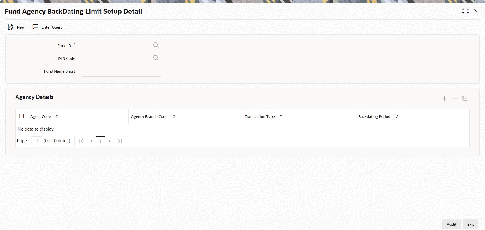

To set up the backdating options for a transaction type for a fund, use the Fund Agency BackDating Limit Setup Detail screen.
  1. On Home screen, type UTDFALMT in the text box and click Next.
    The Fund Agency BackDating Limit Setup Detail screen is displayed.
    Figure 3-3 Fund Agency BackDating Limit Setup Detail
  2. Select New from the Actions menu in the Application tool bar or click New icon to enter the details of the backdating limits that you wish to maintain.

  3. On Fund Agency BackDating Limit Setup Detail screen, specify the fields.
    For more information on fields in the screen, refer the below table.
    Table 3-2 Fund Agency BackDating Limit Setup Detail
