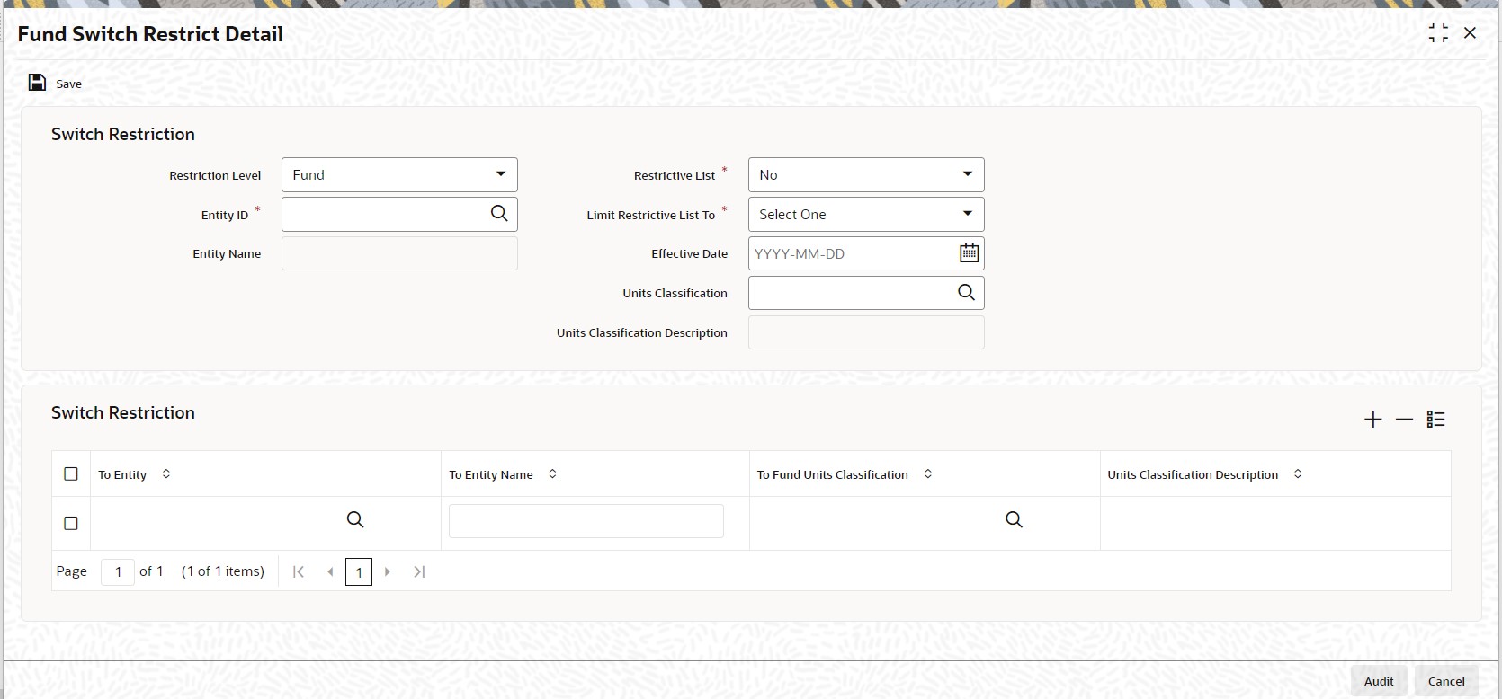

  1. On Home screen, type UTDFNSWR in the text box and click Next.
  2. Select New from the Actions menu in the Application tool bar or click New icon to enter the details of the lists on switch transactions.
    The Fund Switch Restrict Detail screen is displayed.
    Figure 3-5 Fund Switch Restrict Detail
    Before you maintain switch restrictions in the Fund Switch Restrictions screen, you must ensure that,
    • The switching logic for the AMC has been maintained, in the Single Entity Maintenance.
    • Authorized fund rules have been maintained for the requisite funds.
    Maintenance of switch restrictions is not a fund rule, and can be done after the fund rules have been maintained.
    For a fund, you cannot maintain both a positive as well as a restrictive list.
    For more information on fields in the screen, refer the below table.
    Table 3-3 Fund Switch Restrict Detail - Switch Restriction
    Field Description
    Restriction Level Optional
    Select the Restriction Level from the drop-down list. The list displays the following values:
    • Fund
    • Fund Family
    • Legal Entity
    • Fund Type
    Entity ID Alphanumeric; 12 Characters; Mandatory
    Specify the Entity ID. Alternatively, you can select the Entity ID form the option list. The list displays all valid entity ID maintained in the system.
    Entity Name Display
    The system displays the entity name for the selected Entity ID.
    Restrictive List Mandatory
    For a fund, you might require to disallow switch transactions into a few selected funds (a restrictive list); or, you might require maintaining a list of funds into which switch transactions are allowed (a positive list)
    You can indicate that you are maintaining a restrictive list, by choosing Yes from the drop down list. To indicate that the list is a positive list, choose No from the drop-down list.
    If you indicate a restrictive list, switch transactions into any of the selected funds in the list will not be allowed. If you indicate a positive list, switch transactions are allowed only into any of the selected funds in the list. For a fund, only a restrictive list OR a positive list can be maintained, not both.
