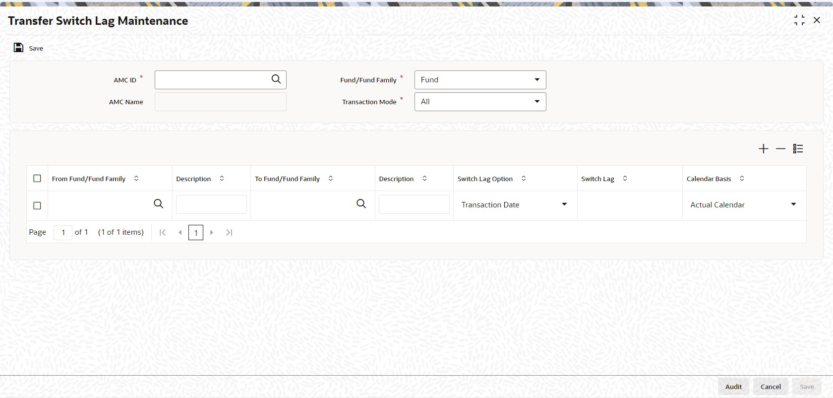

This topic provides the instructions to invoke transfer switch lag maintenance screen details.
You can maintain the lag for the combination of two funds or for two Fund Families of two different unitholders using Transfer Switch Lag Maintenance screen to derive subscription leg transaction date.
- On Home screen, type UTDTSLAG
in the text box and click
Next.The Transfer Switch Lag Maintenance screen is displayed.
Figure 3-9 Transfer Switch Lag Maintenance
- On Transfer Switch Lag Maintenance screen, specify the
fields.For more information on fields in the screen, refer the below table.
Table 3-13 Transfer Switch Lag Maintenance
Field Description AMC ID Alphanumeric; 12 Characters; Mandatory Specify the AMC ID. Alternatively, you can select the AMC ID from the option list. The list displays all valid AMC ID maintained in the system.
AMC Name Display The system displays the description for the selected AMC ID.
Fund/Fund Family Mandatory Select the Fund or Fund Family from the drop-down list. The list displays the following values:
- Fund
- Fund Family
Transaction Mode Mandatory Select the Transaction Mode from the drop-down list. The list displays the following values:
- Amount
- Units
- All
From Fund/Fund Family Alphanumeric; 6 Characters; Optional Specify the from fund or fund family details. Alternatively, you can select the from Fund or Fund Family details from the option list. The list displays all valid from fund or fund family details maintained in the system.
Description Display The system displays the description for the selected from Fund or Fund Family.
To Fund/Fund Family Alphanumeric; 6 Characters; Optional Specify the To fund or fund family details. Alternatively, you can select the To Fund or Fund Family details from the option list. The list displays all valid To fund or fund family details maintained in the system.
Description Display The system displays the description for the selected To Fund or Fund Family.
Switch Lag Option Optional Select the Switch Lag Option from the drop-down list. The list displays the following values:
- Transaction Date
- Settlement Date
- Price Date
- Dealing Date
Switch Lag Alphanumeric; 2 Characters; Optional Specify the switch lag details.
Calendar Basis Optional Select the Calendar Basis from the drop-down list. The list displays the following value:
- Actual Calendar
- System Calendar
- AMC Calendar
- Fund Calendar
