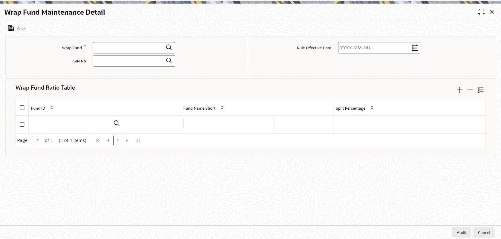

  1. On Home screen, type UTDWRFND in the text box and click Next.
    The Wrap Fund Maintenance Detail screen is displayed.
    Figure 3-37 Wrap Fund Maintenance Detail
  2. Select New from the Actions menu in the Application tool bar or click new icon to enter the details of the wrap fund you wish to maintain.
  3. On Wrap Fund Maintenance Detail screen, specify the fields.

    Table 3-48 Wrap Fund Maintenance Detail
    Field Description
    Wrap Fund ID Alphanumeric; 6 Characters; Mandatory
    Specify the ID of the Wrap Fund. The list contains authorized funds in the system.
    ISIN No Alphanumeric; 12 Characters; Optional
    The system displays the ISIN Number. However, you amend this value.
    If you specify the ISIN Code, the ID of the fund is displayed in Wrap Fund ID field and vice versa.
    Rule Effective Date Date Format, Mandatory
    Specify the date from which the fund is effective as a wrap fund in the system. This rule effective date is different from the effective date of the actual fund in the system, which is specified in the Fund Demographics profile for the fund.
    Specify the ID of the underlying investment fund. The list contains authorized funds in the system
    Fund Name Short Display
    The system displays the short fund name for the selected Fund ID.
    Split Percentage Numeric; 5 Characters; Mandatory
    Specify the percentage limit for investment into the selected underlying fund. This percentage must not exceed one hundred percent.
