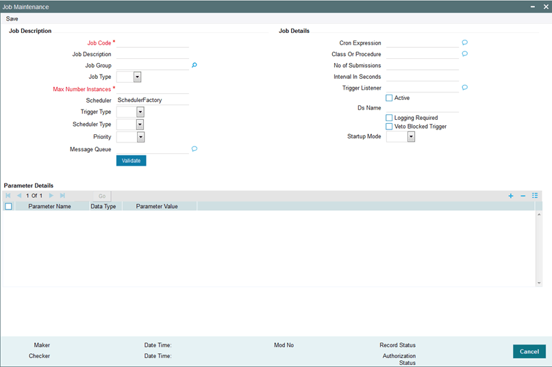

3.1 Interface Job definition
This topic provides the instructions for interface job definition.
For Interface Job maintenance, user has to maintain com.ofss.scheduler.quartz.fcis.FCISImpExpSchExecutor class.
  • Event Based
    For Event based job scheduling, EVENTCODE need to be maintained in Parameters. Valid Event Codes are available in Eventstbl.
  • Time Based
    To maintain Time based job, we have to maintain cron expression.
  • Timezone Based
    For Timezone based job scheduling, valid timezone need to be maintained in parameters. Timezone parameter should have standard Quarz supported timezone value.
