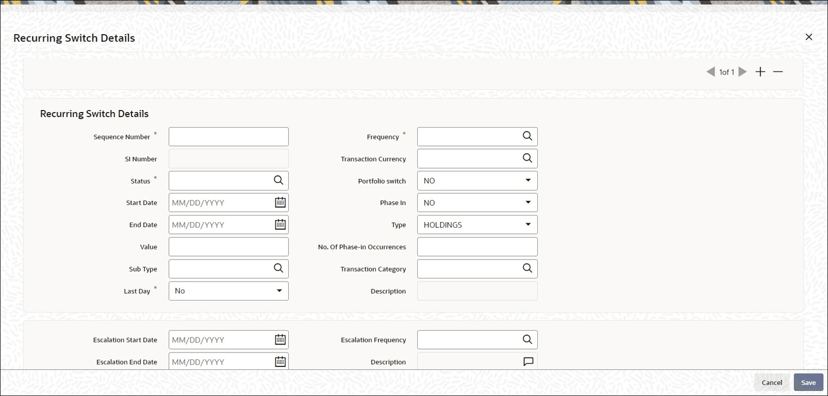

2.1.12 Recurring Switch Details Button
This topic explains the Recurring Switch Details button of Policy Maintenance Detail screen.
- On Policy Maintenance Detail screen, click Recurring Switch Details button to enter the details of any recurring switch transactions that the Policy Holder may want to enter into in this section.The details maintained would be standing instructions for a switch transaction.The Recurring Switch Details screen is displayed.
Figure 2-13 Policy Maintenance Detail_Recurring Switch Details Button
- On Recurring Switch Details screen, specify the fields. For more information on fields, refer to the field description table.
