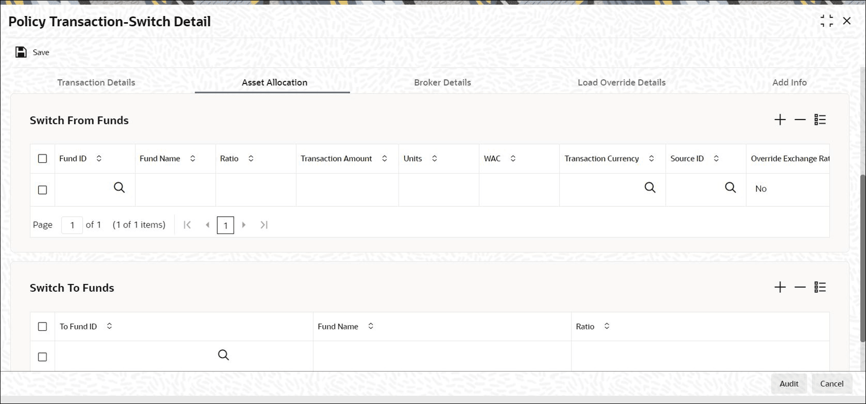

- On Policy Transaction-Switch Detail screen, click Asset Allocation tab.The Asset Allocation details are displayed.
Figure 4-5 Policy Transaction-Switch Detail_Asset Allocation Tab

- On Asset Allocation Tab, specify the fields. For more information on fields, refer to the field description table.
