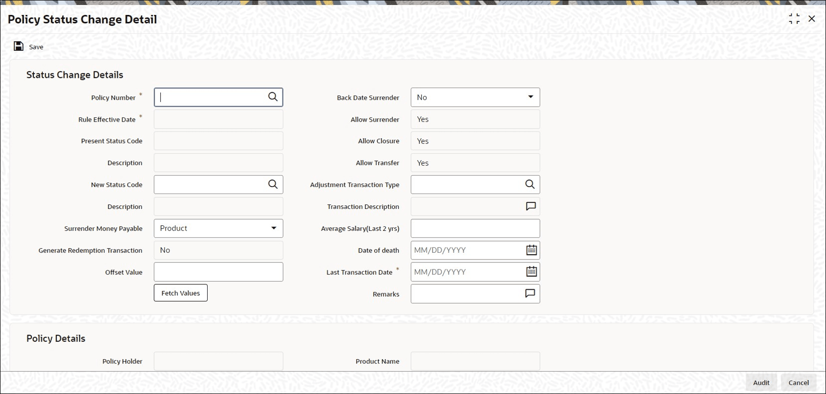

- Start the Policy Status Change Detail screen.
- Enter information in the Policy Status Change Detail screen.
- Save the information entered.
- On Home screen, type LEDPLSTA in the text box, and click Next.The Policy Status Change Detail screen is displayed.
- On Policy Status Change Detail screen, click New to enter the details.For more information on fields, refer to the field description table.
Table 6-1 Policy Status Change Detail - Field Description
Field Description Status Change Details This section displays the following details.
Policy Number Alphanumeric; 16 Characters; Mandatory

Rule Effective Date Display
When you enter the Policy Number, the Rule Effective Date, which is the date from which the new status of the Policy is effective, will be displayed. You will not be allowed to change this field.
Present Status Code Display
When you enter the Policy Number, the existing status of the Policy will be displayed. You will not be allowed to change this field.
Description Display
Each status carries a Status Code. The existing status code description of the Policy will be displayed. You will not be allowed to change this field.
New Status Alphanumeric; 4 Characters; Optional
Select the new status of the Policy from the option list.

Surrender Money Payable Optional
Indicate to whom the surrender money is payable from the drop-down list. The list displays the following values:- Product
- Client
Generate Redemption Transaction Optional
If you want redemption transaction to be generated for the policy, select Yes. Else select No.

Offset Value Numeric; 22 Characters; Optional
Specify the amount that will be deducted from the surrender money payable to the Policy Holder.
Back Date Surrender Optional
During a status change to Surrender or Claim, a 100% redemption transaction will be generated. If you want redemption transaction to be back dated, select Yes. The transaction date can then be entered in the field Last Transaction Date.
Note: This field will be enabled only for the options Claim and Surrender in the drop-down list against the field New Status.

Average Salary (Last 2 Years) Numeric; 22 Characters; Optional
Enter the average salary of the Policy Holder in the last two years.
Note: This field will be enabled only for the options Death Without Commutation, Death With Commutation, Policy Holder Retirement, and Early Policy Holder Retirement in the drop-down list against the field New Status.
Date of Death Date Format; Optional
Enter the date of death of the Policy Holder.
Note: This check box will be enabled only for the options Death Without Commutation, Death With Commutation, Policy Holder Retirement, and Early Policy Holder Retirement in the drop-down list against the field New Status.
Last Transaction Date Date Format; Mandatory if Back Date Surrender is selected as Yes
Specify the last transaction date.
Note: The date that you enter here, should necessarily be between the date that was originally displayed in this box, and today’s date.
Remarks Alphanumeric; 255 Characters; Optional
Specify remarks, if any.
After giving policy number and New Status code, if you click Fetch button, the system displays all details related to policy.
