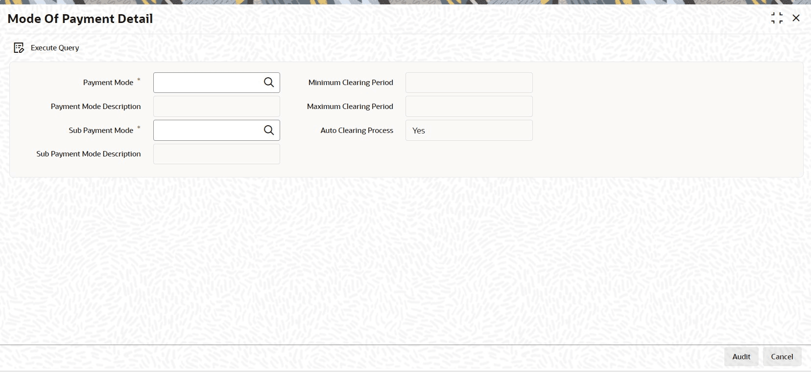

  1. On Home screen, type PADMPAYS in the text box, and click Next.
    The Mode Of Payment Detail screen is displayed.
    Figure 1-94 Mode Of Payment Detail
  2. On Mode Of Payment Detail screen, click New to enter the details.
  3. All Payment modes will be available in this screen. For Pension module; pension orders will support Cheque and Money transfer payment modes only.
    You can use system calendar to derive the maximum clearing period.
