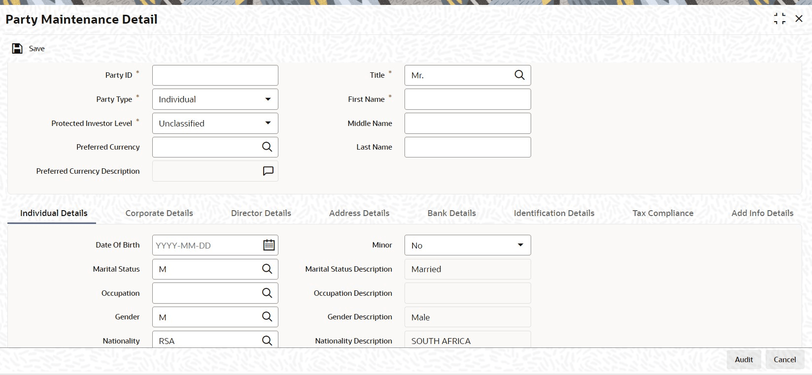

This topic provides the systematic instructions to define Party Maintenance in pension module.
You can create customers and other parties in the system. The system creates any person/ institution involved in pension processing as parties and attaches respective roles. The system identifies each party by a unique Party ID.
You cannot amend Address, Bank and Identification details from Party Maintenance screen. You can amend the same from standalone screens only. However, you cannot amend the bank details even in stand-alone screen except last verified date and status.
Any amendment done in party screen which has the role of investor or employee will be handoff to TA system to enrich the investor accounts.
The following section data from party screen will be handed-off to TA:
- Basic individual/corporate details
- Director details for corporate parties
- Address details
- Bank and ID details
Following details will not be handed-off to TA:
- Tax compliance
- Additional information
- Unitholder Income distribution setup (UH IDS) for the pension investment accounts in FCIS should be of re-investments only. The system validates the same using Pre-EOD check.
- The Pre-EOD sequence number 3050 checks the number of IDS setup with payout option, for Pension Administration investment accounts.
